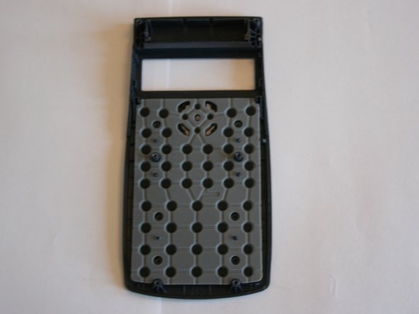

  5. Casio fx-82MS Teardown, Remove PCB from case: crwdns2935265:05crwdnd2935265:01crwdnd2935265:03crwdne2935265:0 Casio fx-82MS Teardown, Remove PCB from case: crwdns2935265:05crwdnd2935265:02crwdnd2935265:03crwdne2935265:0 Casio fx-82MS Teardown, Remove PCB from case: crwdns2935265:05crwdnd2935265:03crwdnd2935265:03crwdne2935265:0
    • Insert a spudger in between the PCB and the rubber button holder.
    • Carefully remove the PCB and make sure not to damage the LCD ribbon cable.

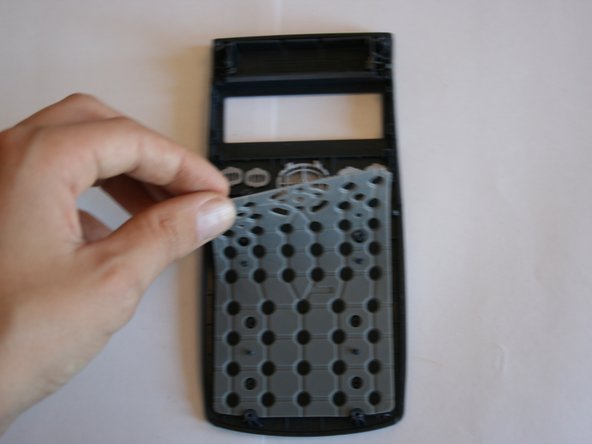

  6. Casio fx-82MS Teardown, Remove button holder: crwdns2935265:06crwdnd2935265:01crwdnd2935265:03crwdne2935265:0 Casio fx-82MS Teardown, Remove button holder: crwdns2935265:06crwdnd2935265:02crwdnd2935265:03crwdne2935265:0 Casio fx-82MS Teardown, Remove button holder: crwdns2935265:06crwdnd2935265:03crwdnd2935265:03crwdne2935265:0
    • Peel off the rubber button holder starting in the top left corner.
