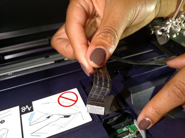

  3. Brother MFC-240C Teardown: crwdns2935265:03crwdnd2935265:01crwdnd2935265:03crwdne2935265:0 Brother MFC-240C Teardown: crwdns2935265:03crwdnd2935265:02crwdnd2935265:03crwdne2935265:0 Brother MFC-240C Teardown: crwdns2935265:03crwdnd2935265:03crwdnd2935265:03crwdne2935265:0
    • Gently lift up ribbon cable and pull it through holder then remove ribbon cable from its track.

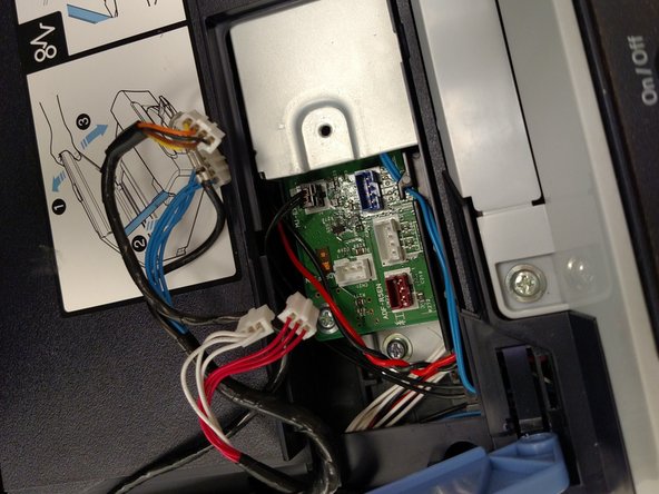

  5. Brother MFC-240C Teardown: crwdns2935265:05crwdnd2935265:01crwdnd2935265:03crwdne2935265:0 Brother MFC-240C Teardown: crwdns2935265:05crwdnd2935265:02crwdnd2935265:03crwdne2935265:0 Brother MFC-240C Teardown: crwdns2935265:05crwdnd2935265:03crwdnd2935265:03crwdne2935265:0
    • Remove the 4 plugs and unscrew ground-wire then place the plugs to the side.

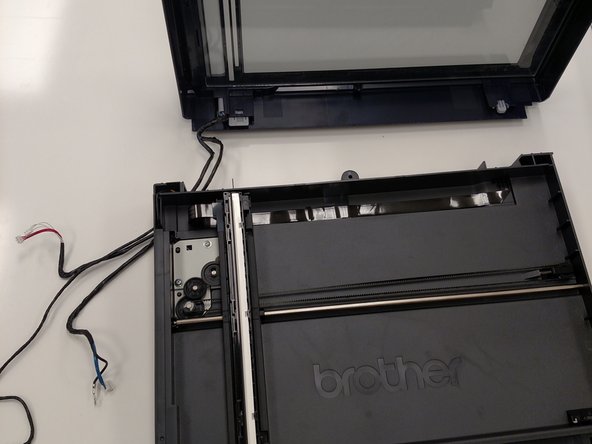

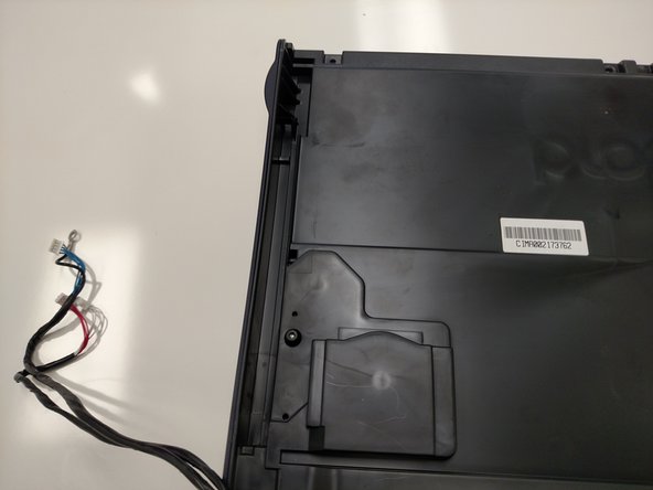

  9. Brother MFC-240C Teardown: crwdns2935265:09crwdnd2935265:01crwdnd2935265:03crwdne2935265:0 Brother MFC-240C Teardown: crwdns2935265:09crwdnd2935265:02crwdnd2935265:03crwdne2935265:0 Brother MFC-240C Teardown: crwdns2935265:09crwdnd2935265:03crwdnd2935265:03crwdne2935265:0
    • Place on opposite face, and gently pry upper and lower scanner portions apart. Remove the 4 plugs from the lower scanner portion.

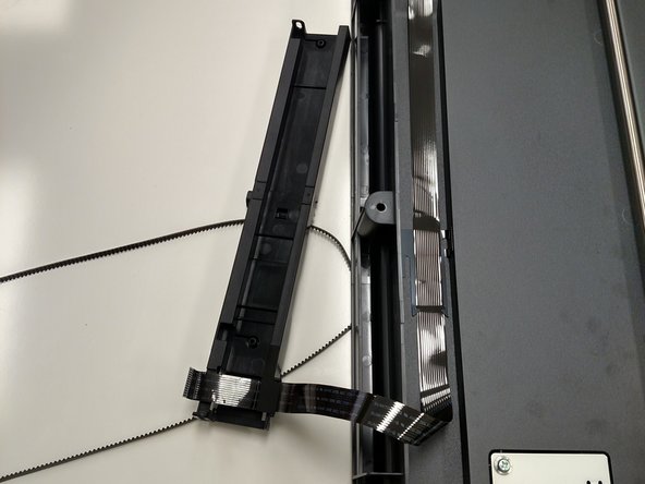

  10. Brother MFC-240C Teardown: crwdns2935265:010crwdnd2935265:01crwdnd2935265:03crwdne2935265:0 Brother MFC-240C Teardown: crwdns2935265:010crwdnd2935265:02crwdnd2935265:03crwdne2935265:0 Brother MFC-240C Teardown: crwdns2935265:010crwdnd2935265:03crwdnd2935265:03crwdne2935265:0
    • To remove image sensor, detach the wire strip and pull it out. Remove the two springs that are under the image sensor after its removal.

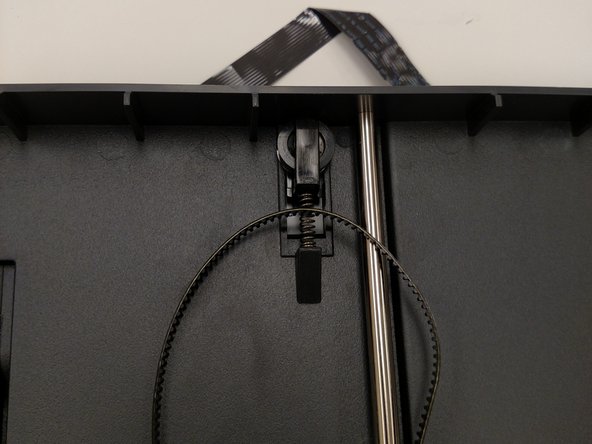

  11. Brother MFC-240C Teardown: crwdns2935265:011crwdnd2935265:01crwdnd2935265:03crwdne2935265:0 Brother MFC-240C Teardown: crwdns2935265:011crwdnd2935265:02crwdnd2935265:03crwdne2935265:0 Brother MFC-240C Teardown: crwdns2935265:011crwdnd2935265:03crwdnd2935265:03crwdne2935265:0
    • To remove the belt, first place the image sensor to the side then press down on the gear base to loosen belt and remove from the gear.

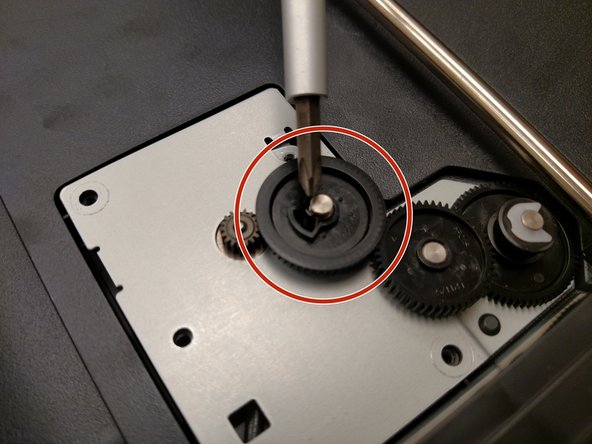

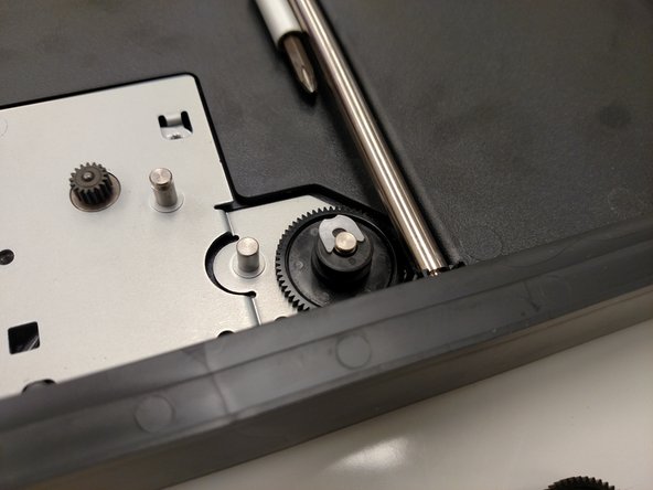

  12. Brother MFC-240C Teardown: crwdns2935265:012crwdnd2935265:01crwdnd2935265:03crwdne2935265:0 Brother MFC-240C Teardown: crwdns2935265:012crwdnd2935265:02crwdnd2935265:03crwdne2935265:0 Brother MFC-240C Teardown: crwdns2935265:012crwdnd2935265:03crwdnd2935265:03crwdne2935265:0
    • Remove the 3 highlighted screws. For the gear driven by the motor, press the tab in highlighted gear to remove set gear. For the gear that was attached to belt, remove C-clip to remove gear then pull the last gear off.

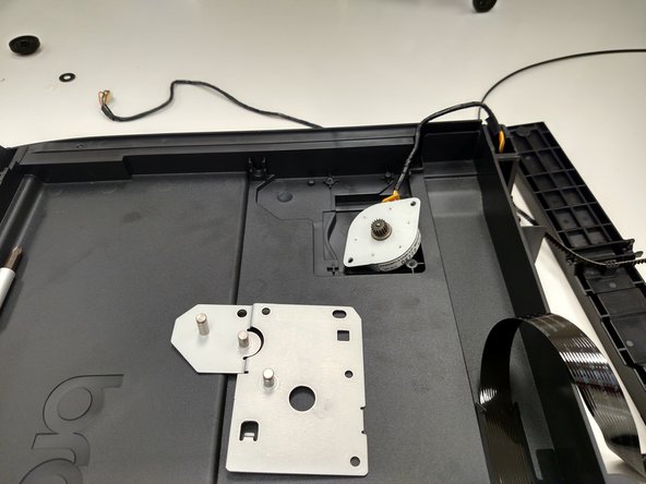

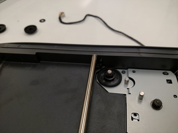

  13. Brother MFC-240C Teardown: crwdns2935265:013crwdnd2935265:01crwdnd2935265:02crwdne2935265:0 Brother MFC-240C Teardown: crwdns2935265:013crwdnd2935265:02crwdnd2935265:02crwdne2935265:0
    • After the removing gears, lift up on the retained end of metal rod and pull out the other side.
  14. Brother MFC-240C Teardown: crwdns2935265:014crwdnd2935265:01crwdnd2935265:02crwdne2935265:0 Brother MFC-240C Teardown: crwdns2935265:014crwdnd2935265:02crwdnd2935265:02crwdne2935265:0
    • Once the rod has been removed, remove the metal plate in which the gears were sitting then take out the motor.
