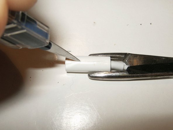

  4. Apple Lightning to Headphone Jack Adapter Teardown, Cutting the lightning connector open: crwdns2935265:04crwdnd2935265:01crwdnd2935265:03crwdne2935265:0 Apple Lightning to Headphone Jack Adapter Teardown, Cutting the lightning connector open: crwdns2935265:04crwdnd2935265:02crwdnd2935265:03crwdne2935265:0 Apple Lightning to Headphone Jack Adapter Teardown, Cutting the lightning connector open: crwdns2935265:04crwdnd2935265:03crwdnd2935265:03crwdne2935265:0
    • Cutting length wise on one side
    • as well as the opposite site
    • Then flipping the two halves that were created by the cuts.
  5. Apple Lightning to Headphone Jack Adapter Teardown: crwdns2935265:05crwdnd2935265:01crwdnd2935265:03crwdne2935265:0 Apple Lightning to Headphone Jack Adapter Teardown: crwdns2935265:05crwdnd2935265:02crwdnd2935265:03crwdne2935265:0 Apple Lightning to Headphone Jack Adapter Teardown: crwdns2935265:05crwdnd2935265:03crwdnd2935265:03crwdne2935265:0
    • This makes for an easy removal.
    • The next thing to be removed is the ground shield.
    • Using a pair of small side cutters that shield is easily removed as well.
  6. Apple Lightning to Headphone Jack Adapter Teardown: crwdns2935265:06crwdnd2935265:01crwdnd2935265:03crwdne2935265:0 Apple Lightning to Headphone Jack Adapter Teardown: crwdns2935265:06crwdnd2935265:02crwdnd2935265:03crwdne2935265:0 Apple Lightning to Headphone Jack Adapter Teardown: crwdns2935265:06crwdnd2935265:03crwdnd2935265:03crwdne2935265:0
    • Just a matter of using the cutters on one end
    • and rolling it around the connector.
    • This shows the destructive nature of this teardown
  7. Apple Lightning to Headphone Jack Adapter Teardown: crwdns2935265:07crwdnd2935265:01crwdnd2935265:03crwdne2935265:0 Apple Lightning to Headphone Jack Adapter Teardown: crwdns2935265:07crwdnd2935265:02crwdnd2935265:03crwdne2935265:0 Apple Lightning to Headphone Jack Adapter Teardown: crwdns2935265:07crwdnd2935265:03crwdnd2935265:03crwdne2935265:0
    • The connector is now left with another plastic covering.
    • Luckily the removal of the ground shield seems to have open slots lengthwise in the plastic covering.
    • Using these slots, the plastic needs to be carefully pulled away from the circuit board.

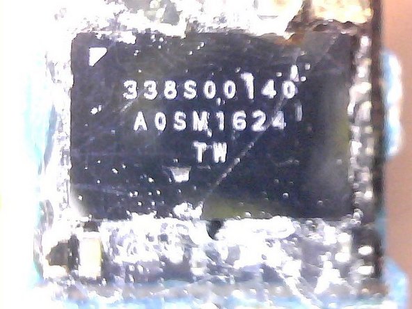

  8. Apple Lightning to Headphone Jack Adapter Teardown: crwdns2935265:08crwdnd2935265:01crwdnd2935265:03crwdne2935265:0 Apple Lightning to Headphone Jack Adapter Teardown: crwdns2935265:08crwdnd2935265:02crwdnd2935265:03crwdne2935265:0 Apple Lightning to Headphone Jack Adapter Teardown: crwdns2935265:08crwdnd2935265:03crwdnd2935265:03crwdne2935265:0
    • Here is the business end with the cover removed.
    • This side shows what appears to be the DAC inside this adapter
    • Close-up of the circuit board shows Apple's fascination with adhesive and other sticky substances. Both sides of the circuit board are covered with it.
  9. Apple Lightning to Headphone Jack Adapter Teardown: crwdns2935265:09crwdnd2935265:01crwdnd2935265:03crwdne2935265:0 Apple Lightning to Headphone Jack Adapter Teardown: crwdns2935265:09crwdnd2935265:02crwdnd2935265:03crwdne2935265:0 Apple Lightning to Headphone Jack Adapter Teardown: crwdns2935265:09crwdnd2935265:03crwdnd2935265:03crwdne2935265:0
    • A bit more of a close up of one side
    • as well as the other. As more information becomes available about the DAC this teardown will be edited to reflect those.
    • Here are the markings on the DAC 338S00140 A0SM1624 TW
