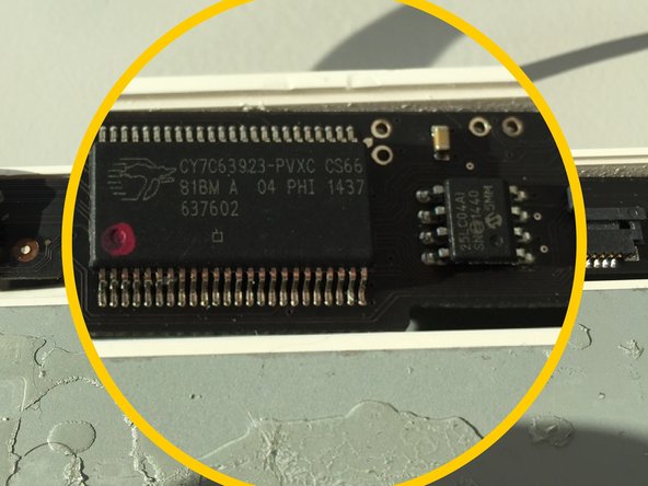

  6. Apple Keyboard A1243 Teardown, Inspecting Logic Board 1: crwdns2935265:06crwdnd2935265:01crwdnd2935265:03crwdne2935265:0 Apple Keyboard A1243 Teardown, Inspecting Logic Board 1: crwdns2935265:06crwdnd2935265:02crwdnd2935265:03crwdne2935265:0 Apple Keyboard A1243 Teardown, Inspecting Logic Board 1: crwdns2935265:06crwdnd2935265:03crwdnd2935265:03crwdne2935265:0
    • Cypress CY7C63923 (Low-Speed USB Peripheral Controller)
    • ST 95040W (4kbit EEPROM)
    • Cypress CY7C65630-56L (Low Power USB 2.0 Hub)
    • Microchip 2026-1YM (Dual-Channel Power Distribution Switch)
  7. Apple Keyboard A1243 Teardown, Inspecting Logic Board 2: crwdns2935265:07crwdnd2935265:01crwdnd2935265:03crwdne2935265:0 Apple Keyboard A1243 Teardown, Inspecting Logic Board 2: crwdns2935265:07crwdnd2935265:02crwdnd2935265:03crwdne2935265:0 Apple Keyboard A1243 Teardown, Inspecting Logic Board 2: crwdns2935265:07crwdnd2935265:03crwdnd2935265:03crwdne2935265:0
    • The yellow circled element is a Cypress CY7C63923-PVXC, a "Low-Speed USB Peripheral Controller" .
    • The blue circled element is a Cypress CY7C65630, a "Low-Power USB 2.0 Hub Controller".
