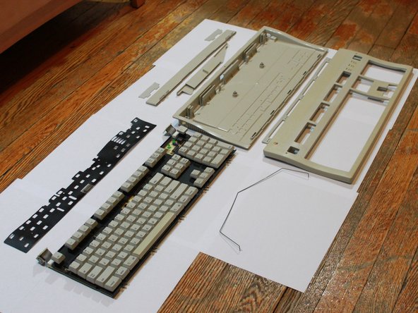

    • Here's the keyboard we will be working on today. She's not beautiful, but she's mine.
    • My AEKII is a US made with Alps switches.
    • Be extremely careful when working with vintage plastics. They are very brittle and can break easily.
    • While the keys are PBT plastic, the case and spacebar are ABS. ABS plastics yellow over time.
    • Interestingly, this keyboard came with a number of plastic overlays that sat over the function keys to show their, well, function. Often you will find the area around the function keys has yellowed much less than the rest of the keyboard, as seen in photo 3.

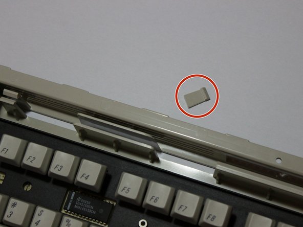

    • Now we can take a closer look at the PCB!
    • The brains of this keyboard is a Toshiba TC4515BP binary controller.
    • A Fairchild CD4515BCN Decoder
    • A GD54/74LS04 Hex Inverter
    • 3 green indicator LEDs

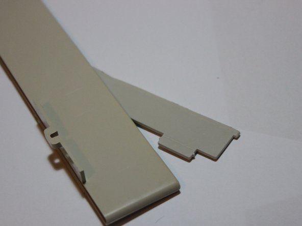

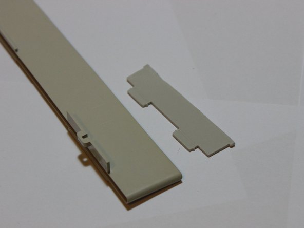

    • Remove the spring bar from the foot.
    • Release three sets of clips from the foot by pressing outward while lifting up. The back will need to be bowed out in order to remove the larger bump used as a control switch in the center.
    • It is very easy to break a tab - I had a casualty doing this teardown :[
    • Lift the foot up and away from the case. It should easily separate into two parts.

    • All done!
    • To reassemble the keyboard, follow this guide in reverse order.
    • Again, note that vintage plastic is very brittle. Be very careful with your tabs - I lost one!
    • Bye bye, tab. Good thing there were two of you.
