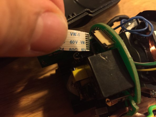

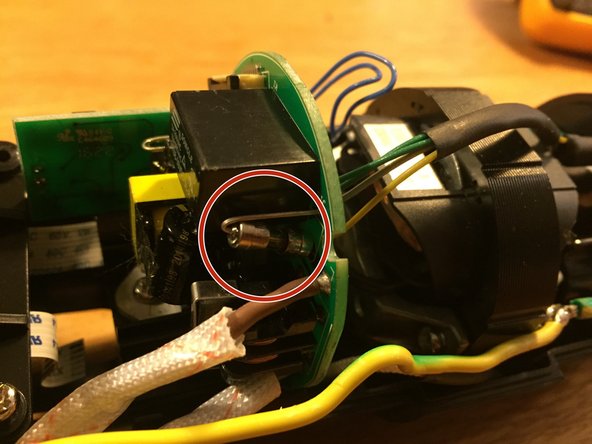

  4. Anova Precision Cooker BT WiFi Teardown, Remove the control unit: crwdns2935265:04crwdnd2935265:01crwdnd2935265:03crwdne2935265:0 Anova Precision Cooker BT WiFi Teardown, Remove the control unit: crwdns2935265:04crwdnd2935265:02crwdnd2935265:03crwdne2935265:0 Anova Precision Cooker BT WiFi Teardown, Remove the control unit: crwdns2935265:04crwdnd2935265:03crwdnd2935265:03crwdne2935265:0
    • Remove the control unit by unscrewing the two screws that hold it in place
    • You may then remove the bottom casing as well if interested
    • Notice to remove the control cable before violently showing the control unit aside
    • The fuse is clearly visible next to the power cord. To change it, you need to unsolder it and solder a new one in place
  5. Anova Precision Cooker BT WiFi Teardown, Additinoal dismantling: crwdns2935265:05crwdnd2935265:01crwdnd2935265:03crwdne2935265:0 Anova Precision Cooker BT WiFi Teardown, Additinoal dismantling: crwdns2935265:05crwdnd2935265:02crwdnd2935265:03crwdne2935265:0 Anova Precision Cooker BT WiFi Teardown, Additinoal dismantling: crwdns2935265:05crwdnd2935265:03crwdnd2935265:03crwdne2935265:0
    • The temperature control adjuster can be removed by the two flushed screws
    • To remove the control cable, lift the small plastic shimmer an then pull out the cable

My unit has a power fuse located right under the power cord plug at the back of the unit. It unclips and slides out for easy replacement. I the fuse which you show in your photos inside the unit a different fuse than the one I am referring, perhaps an older model. I am curretly experiencing a problem with my unit that I would like very much to resolve. As I'm located in Brazil, it is virtually impossible to get service for my unit. Thaty and the fact that I bought the unit used from a friend compounds the issue. It was however, working perfectly until yesterday when I noticed that the unit is not heating the water. The unit runs and lights up and everything appears to be working fine, but the water is not heating. I have tried cleaning the insides with vinegar and I have tried putting heated water to see if the thermometer is reading the temperature of the water, which it is. After a few minutes however, the temperature begins to drop rather than heat up to my set temperature.
