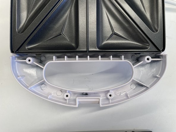

  3. Anko 2 Sandwich Jaffle Maker Teardown, Removal of Base Internal Handle Plate: crwdns2935265:03crwdnd2935265:01crwdnd2935265:02crwdne2935265:0 Anko 2 Sandwich Jaffle Maker Teardown, Removal of Base Internal Handle Plate: crwdns2935265:03crwdnd2935265:02crwdnd2935265:02crwdne2935265:0
    • Open up the product.
    • Use a Philips-Head Screwdriver to remove these 4 screws.
    • The plate can then be removed.

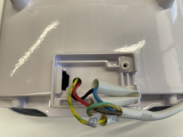

  7. Anko 2 Sandwich Jaffle Maker Teardown, Removal of Wire Covering: crwdns2935265:07crwdnd2935265:01crwdnd2935265:02crwdne2935265:0 Anko 2 Sandwich Jaffle Maker Teardown, Removal of Wire Covering: crwdns2935265:07crwdnd2935265:02crwdnd2935265:02crwdne2935265:0
    • Flip product over so the bottom is facing upwards.
    • Remove the 2 highlighted screws.
    • Slide out the black cover. Keeping in mind there is a tab on the left hand side.
  8. Anko 2 Sandwich Jaffle Maker Teardown, Removal of Wiring.: crwdns2935265:08crwdnd2935265:01crwdnd2935265:01crwdne2935265:0
    • After removing the wire casing, gently pull on the wires and feed them through the hole. It should come out as a whole unit.

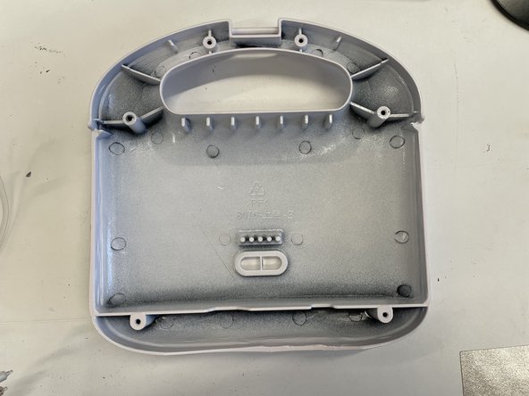

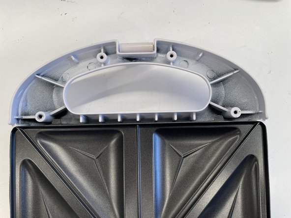

  10. Anko 2 Sandwich Jaffle Maker Teardown, Removal of Top Internal Handle Plate: crwdns2935265:010crwdnd2935265:01crwdnd2935265:02crwdne2935265:0 Anko 2 Sandwich Jaffle Maker Teardown, Removal of Top Internal Handle Plate: crwdns2935265:010crwdnd2935265:02crwdnd2935265:02crwdne2935265:0
    • Open up the product and lay flat on the top side
    • Repeating Step#3, use a Philips Head screwdriver to remove the 4 screws that are highlighted.

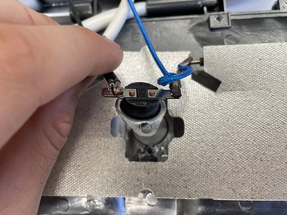

  13. Anko 2 Sandwich Jaffle Maker Teardown, Removal of Thermostat: crwdns2935265:013crwdnd2935265:01crwdnd2935265:02crwdne2935265:0 Anko 2 Sandwich Jaffle Maker Teardown, Removal of Thermostat: crwdns2935265:013crwdnd2935265:02crwdnd2935265:02crwdne2935265:0
    • Once screws have been removed, gently wiggle and dislodge the thermostat.
    • NOTE: There will be a layer of thermal paste between the thermostat and heating plate. Grab an old rag to wipe off.
  14. Anko 2 Sandwich Jaffle Maker Teardown, Removal of Heat Shield: crwdns2935265:014crwdnd2935265:01crwdnd2935265:01crwdne2935265:0
    • Once the thermostat has been removed, gently grab the heat shield cover and remove.

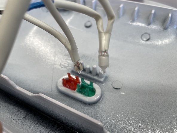

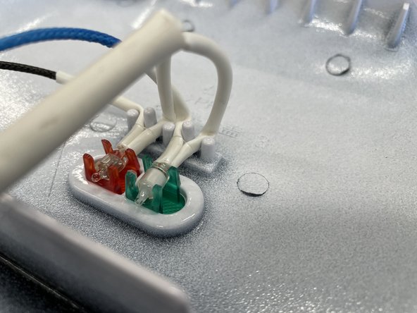

  15. Anko 2 Sandwich Jaffle Maker Teardown, Removal of LED's: crwdns2935265:015crwdnd2935265:01crwdnd2935265:03crwdne2935265:0 Anko 2 Sandwich Jaffle Maker Teardown, Removal of LED's: crwdns2935265:015crwdnd2935265:02crwdnd2935265:03crwdne2935265:0 Anko 2 Sandwich Jaffle Maker Teardown, Removal of LED's: crwdns2935265:015crwdnd2935265:03crwdnd2935265:03crwdne2935265:0
    • Pinch and slide up the 2 highlighted silicone stoppers.
    • Once stoppers have been removed, apply slight force the remove the LED's from respected colours.

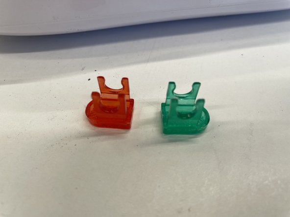

  16. Anko 2 Sandwich Jaffle Maker Teardown, Removal of Coloured Diffusers: crwdns2935265:016crwdnd2935265:01crwdnd2935265:02crwdne2935265:0 Anko 2 Sandwich Jaffle Maker Teardown, Removal of Coloured Diffusers: crwdns2935265:016crwdnd2935265:02crwdnd2935265:02crwdne2935265:0
    • Pinch the extrusions of the coloured diffuser and apply slight downward force to remove via the outer side of the product.
    • NOTE: Arrows indicate where to pinch.

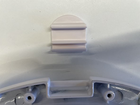

  17. Anko 2 Sandwich Jaffle Maker Teardown, Removal of Clip: crwdns2935265:017crwdnd2935265:01crwdnd2935265:03crwdne2935265:0 Anko 2 Sandwich Jaffle Maker Teardown, Removal of Clip: crwdns2935265:017crwdnd2935265:02crwdnd2935265:03crwdne2935265:0 Anko 2 Sandwich Jaffle Maker Teardown, Removal of Clip: crwdns2935265:017crwdnd2935265:03crwdnd2935265:03crwdne2935265:0
    • This is a snap fit piece. Apply slight pressure to one side of the clip and work one side first to pop off from the casing.
    • The outer casing can now be fully separated from the heating plates.

  19. Anko 2 Sandwich Jaffle Maker Teardown, Separation of Heating Plates.: crwdns2935265:019crwdnd2935265:01crwdnd2935265:01crwdne2935265:0
    • Simply apply an angle to both heating elements and release from the hinge connection.
