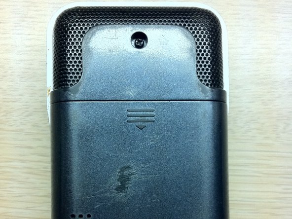

    • Open the back battery cover

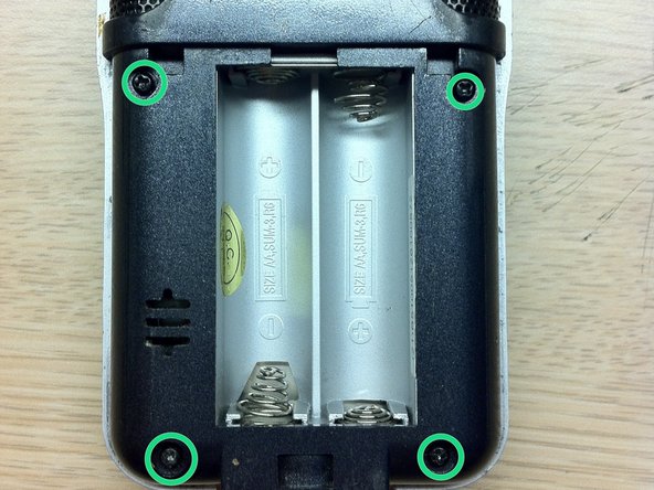

    • Unscrew the four back screws
