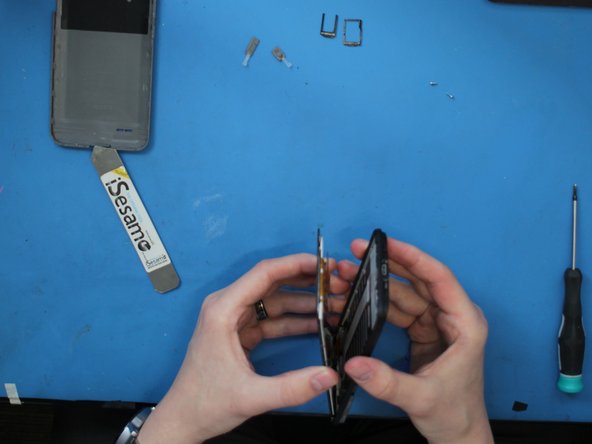

    • Taking a iSesmo to the back cover snaps off a few holding snaps around the phone. I do like that sound...
  3. Alcatel Go Play (7048W) Teardown: crwdns2935265:03crwdnd2935265:01crwdnd2935265:03crwdne2935265:0 Alcatel Go Play (7048W) Teardown: crwdns2935265:03crwdnd2935265:02crwdnd2935265:03crwdne2935265:0 Alcatel Go Play (7048W) Teardown: crwdns2935265:03crwdnd2935265:03crwdnd2935265:03crwdne2935265:0
    • Taking the back off exposes very little. We find the ability to take off the water proofing doors and two little screws. definitely feeling like an S5 now.
    • The screws at the bottom on either side of the charging port are filled in with a hard coating, assuming for water proofing. I had to scrap away at them to access them. I don't think water proofing post repair is going to be a thing.

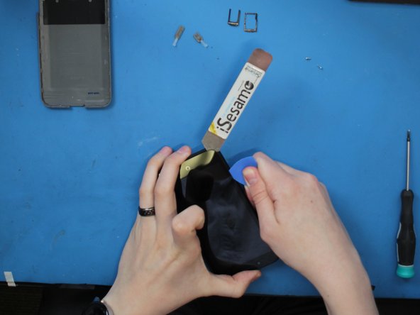

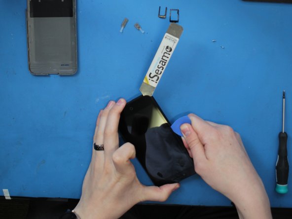

  6. Alcatel Go Play (7048W) Teardown, Open Sesame!: crwdns2935265:06crwdnd2935265:01crwdnd2935265:03crwdne2935265:0 Alcatel Go Play (7048W) Teardown, Open Sesame!: crwdns2935265:06crwdnd2935265:02crwdnd2935265:03crwdne2935265:0 Alcatel Go Play (7048W) Teardown, Open Sesame!: crwdns2935265:06crwdnd2935265:03crwdnd2935265:03crwdne2935265:0
    • Inserting the iSemamo gets a little gap started, then I can get my pick in there and slide it down and around the entire screen.
    • Remember, if it's hard to separate the adhesive, apply more heat. You do can each side individually. No need to heat the middle, there is no adhesive there.
  7. Alcatel Go Play (7048W) Teardown, Screen is off!: crwdns2935265:07crwdnd2935265:01crwdnd2935265:03crwdne2935265:0 Alcatel Go Play (7048W) Teardown, Screen is off!: crwdns2935265:07crwdnd2935265:02crwdnd2935265:03crwdne2935265:0 Alcatel Go Play (7048W) Teardown, Screen is off!: crwdns2935265:07crwdnd2935265:03crwdnd2935265:03crwdne2935265:0

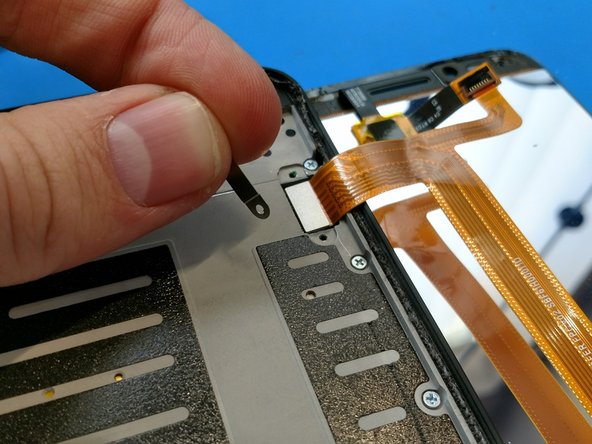

    • Prying slowly and taking care not to rip the flex cable, which is attached to the upper right of device, we can take the screen off.
    • The screen came off easy and the LCD is fine! My flash back to the S5 has ended, for now.
  8. Alcatel Go Play (7048W) Teardown, One connection!: crwdns2935265:08crwdnd2935265:01crwdnd2935265:03crwdne2935265:0 Alcatel Go Play (7048W) Teardown, One connection!: crwdns2935265:08crwdnd2935265:02crwdnd2935265:03crwdne2935265:0 Alcatel Go Play (7048W) Teardown, One connection!: crwdns2935265:08crwdnd2935265:03crwdnd2935265:03crwdne2935265:0
    • Looks like one flex connects the screen assembly to the board.
    • Two screws hold down a retention plate that keep the connector in place.
    • Screen is off! Also, with closer inspection of the screen assembly, the glass and LCD are NOT separate. my attempts to separate them, even with a hot plate created a crack in the LCD. If you're looking for replacement parts, best to get it as one.

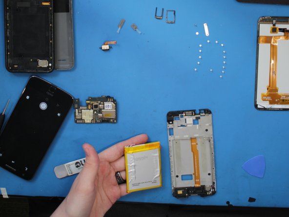

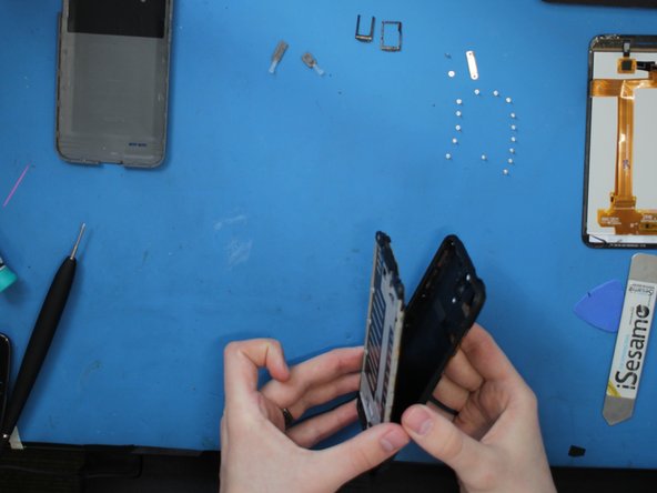

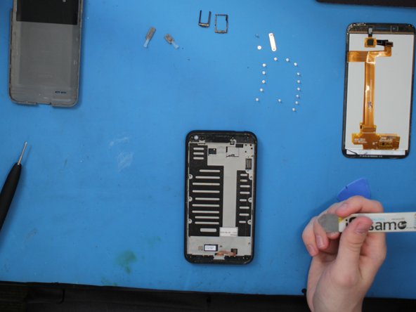

  10. Alcatel Go Play (7048W) Teardown, Screws!: crwdns2935265:010crwdnd2935265:01crwdnd2935265:02crwdne2935265:0 Alcatel Go Play (7048W) Teardown, Screws!: crwdns2935265:010crwdnd2935265:02crwdnd2935265:02crwdne2935265:0
    • Before we go any further, there are 15 total screws keeping the mid frame in place to the back housing.
    • They are all the same, so no worries getting them mixed up!
  11. Alcatel Go Play (7048W) Teardown, Midframe detachment: crwdns2935265:011crwdnd2935265:01crwdnd2935265:03crwdne2935265:0 Alcatel Go Play (7048W) Teardown, Midframe detachment: crwdns2935265:011crwdnd2935265:02crwdnd2935265:03crwdne2935265:0 Alcatel Go Play (7048W) Teardown, Midframe detachment: crwdns2935265:011crwdnd2935265:03crwdnd2935265:03crwdne2935265:0

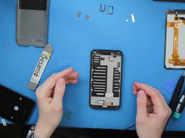

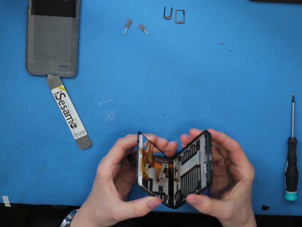

    • Using my iSesamo pry tools, I easily took the mid frame assembly out of the back housing.
    • Be careful, the charging port comes out at a bit of an angle.

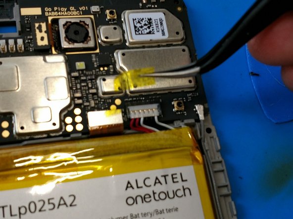

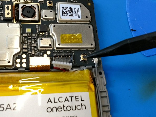

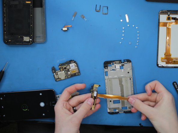

  12. Alcatel Go Play (7048W) Teardown, "Power" to you!: crwdns2935265:012crwdnd2935265:01crwdnd2935265:03crwdne2935265:0 Alcatel Go Play (7048W) Teardown, "Power" to you!: crwdns2935265:012crwdnd2935265:02crwdnd2935265:03crwdne2935265:0 Alcatel Go Play (7048W) Teardown, "Power" to you!: crwdns2935265:012crwdnd2935265:03crwdnd2935265:03crwdne2935265:0
    • If I could've, I would've unplugged the battery by now.
    • There is a little bit of Kapton tape over the connector. Then use a plastic pry tool to unhook the battery.
    • Sorry for the different colored images, I switch to my phone camera for some closer images.
    • The battery is a 2500mAH 9.5WH

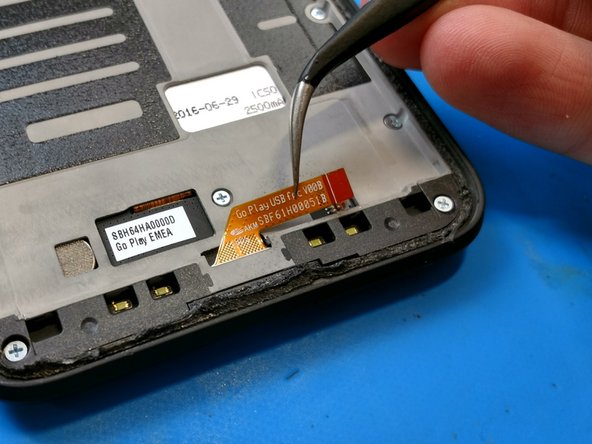

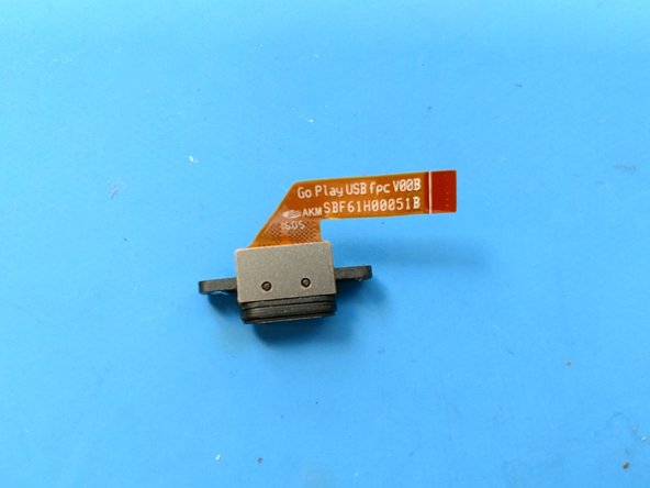

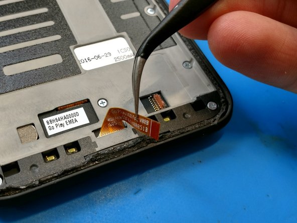

  13. Alcatel Go Play (7048W) Teardown, Charging port in detail: crwdns2935265:013crwdnd2935265:01crwdnd2935265:02crwdne2935265:0 Alcatel Go Play (7048W) Teardown, Charging port in detail: crwdns2935265:013crwdnd2935265:02crwdnd2935265:02crwdne2935265:0
    • At this point as well, I can take out the charging port.
    • It reads Go Play USB fpc V00B AKM SBF61H00051B

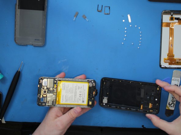

  14. Alcatel Go Play (7048W) Teardown, Out with the board: crwdns2935265:014crwdnd2935265:01crwdnd2935265:03crwdne2935265:0 Alcatel Go Play (7048W) Teardown, Out with the board: crwdns2935265:014crwdnd2935265:02crwdnd2935265:03crwdne2935265:0 Alcatel Go Play (7048W) Teardown, Out with the board: crwdns2935265:014crwdnd2935265:03crwdnd2935265:03crwdne2935265:0
    • A quick discount of the daughter board flex and antenna cable releases the board from the mid frame.
  15. Alcatel Go Play (7048W) Teardown, Daughter board out!: crwdns2935265:015crwdnd2935265:01crwdnd2935265:03crwdne2935265:0 Alcatel Go Play (7048W) Teardown, Daughter board out!: crwdns2935265:015crwdnd2935265:02crwdnd2935265:03crwdne2935265:0 Alcatel Go Play (7048W) Teardown, Daughter board out!: crwdns2935265:015crwdnd2935265:03crwdnd2935265:03crwdne2935265:0
    • A wee bit of heat to melt the adhesive, and the daughter board is almost out, looks like we need to take the battery out first.

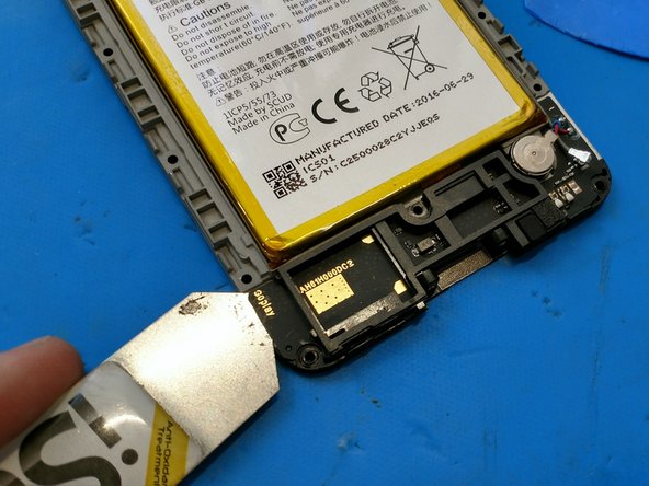

  16. Alcatel Go Play (7048W) Teardown, Out with the battery: crwdns2935265:016crwdnd2935265:01crwdnd2935265:02crwdne2935265:0 Alcatel Go Play (7048W) Teardown, Out with the battery: crwdns2935265:016crwdnd2935265:02crwdnd2935265:02crwdne2935265:0
    • A simple prying to the battery with a plastic pick gets it right out. Remember to use plastic, we don't need a Note 7 here.

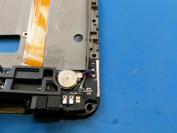

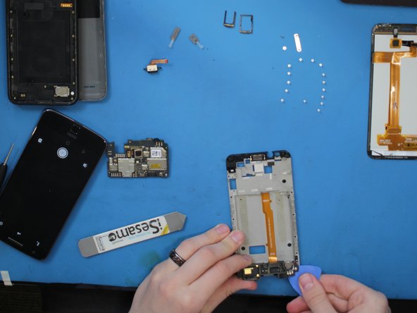

  17. Alcatel Go Play (7048W) Teardown, Out with the daughter board, this time I mean it: crwdns2935265:017crwdnd2935265:01crwdnd2935265:03crwdne2935265:0 Alcatel Go Play (7048W) Teardown, Out with the daughter board, this time I mean it: crwdns2935265:017crwdnd2935265:02crwdnd2935265:03crwdne2935265:0 Alcatel Go Play (7048W) Teardown, Out with the daughter board, this time I mean it: crwdns2935265:017crwdnd2935265:03crwdnd2935265:03crwdne2935265:0
    • Some careful lifting of the board and the flex cable gets the board off the mid frame.

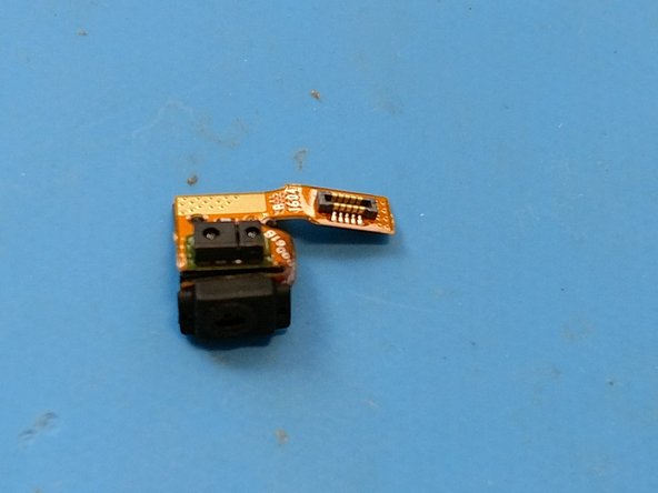

  18. Alcatel Go Play (7048W) Teardown, The board and more: crwdns2935265:018crwdnd2935265:01crwdnd2935265:03crwdne2935265:0 Alcatel Go Play (7048W) Teardown, The board and more: crwdns2935265:018crwdnd2935265:02crwdnd2935265:03crwdne2935265:0 Alcatel Go Play (7048W) Teardown, The board and more: crwdns2935265:018crwdnd2935265:03crwdnd2935265:03crwdne2935265:0

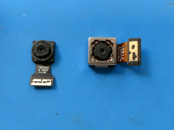

    • We have the board out, time to take the proximity sensor, front facing 5MP camera, and rear facing 8MP camera out. All are simple modular parts.

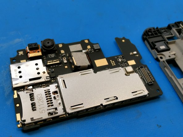

  19. Alcatel Go Play (7048W) Teardown, This is so "Boring": crwdns2935265:019crwdnd2935265:01crwdnd2935265:03crwdne2935265:0 Alcatel Go Play (7048W) Teardown, This is so "Boring": crwdns2935265:019crwdnd2935265:02crwdnd2935265:03crwdne2935265:0 Alcatel Go Play (7048W) Teardown, This is so "Boring": crwdns2935265:019crwdnd2935265:03crwdnd2935265:03crwdne2935265:0

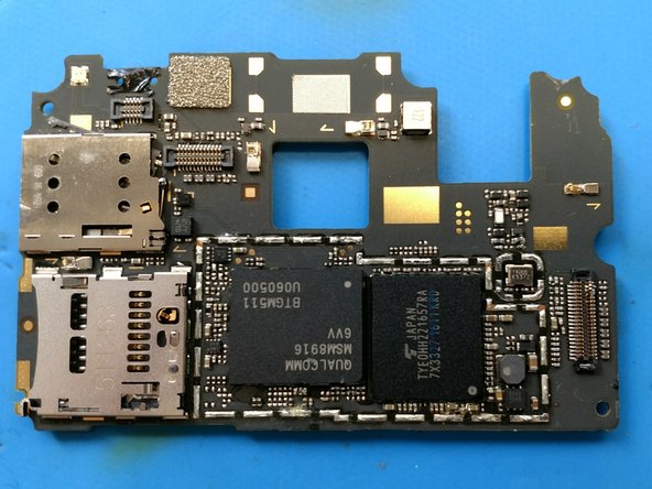

    • I went ahead and took off all of the shielding of the board, front and back.
    • It also looks like the SIM card port reader is on the board. I have a feeling there is little hope for this as a repair.
  20. Alcatel Go Play (7048W) Teardown, Yup, no good: crwdns2935265:020crwdnd2935265:01crwdnd2935265:01crwdne2935265:0
    • Looks like there is little hope for this. For those of you who may not know, that little part there to the left is the reader, it came right off, and has some of the solder pads attached, they are those pinkish copper looking things on the edges and in the middle.
    • Since it pulled the pads off in the original damage, and there are no schematics, I'm not going to even try and run jumpers or rebuilding the pads.
