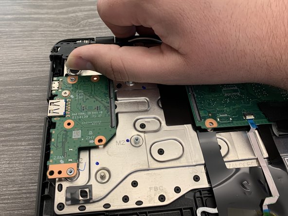

  9. Acer Chromebook 11 C732 Teardown: crwdns2935265:09crwdnd2935265:01crwdnd2935265:03crwdne2935265:0 Acer Chromebook 11 C732 Teardown: crwdns2935265:09crwdnd2935265:02crwdnd2935265:03crwdne2935265:0 Acer Chromebook 11 C732 Teardown: crwdns2935265:09crwdnd2935265:03crwdnd2935265:03crwdne2935265:0
    • Much like other laptops, this device does have a separate daughter board with additional I/O ports. For this device, this board is connected to the rest of the computer with ribbon cables.
    • Using a spudger, we can pop the tabs on the zero insertion force (ZIF) connectors and pull on the blue thumb tabs to remove them.
  10. Acer Chromebook 11 C732 Teardown: crwdns2935265:010crwdnd2935265:01crwdnd2935265:03crwdne2935265:0 Acer Chromebook 11 C732 Teardown: crwdns2935265:010crwdnd2935265:02crwdnd2935265:03crwdne2935265:0 Acer Chromebook 11 C732 Teardown: crwdns2935265:010crwdnd2935265:03crwdnd2935265:03crwdne2935265:0
    • There are three 4.65 mm screws holding the daughterboard in place. Two of those screws hold a screen hinge in place. Once the screws are removed, you are going to need to lift the hinge to remove the board.
  11. Acer Chromebook 11 C732 Teardown: crwdns2935265:011crwdnd2935265:01crwdnd2935265:02crwdne2935265:0 Acer Chromebook 11 C732 Teardown: crwdns2935265:011crwdnd2935265:02crwdnd2935265:02crwdne2935265:0
    • The USB-C port can be seen in the top left corner of the first picture, with the USB-A port right below it.
    • In the second picture, we flipped the board over to show some of the additional information on the board.
    • Through some additional digging, I was able to find the manufacturer part numbers are the following: 55.GVJN7.001.

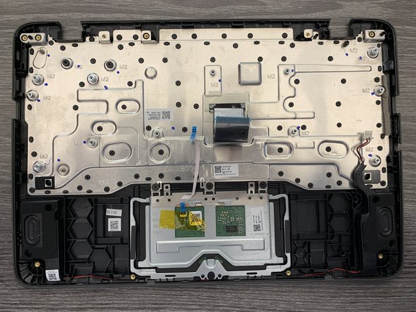

  15. Acer Chromebook 11 C732 Teardown: crwdns2935265:015crwdnd2935265:01crwdnd2935265:02crwdne2935265:0 Acer Chromebook 11 C732 Teardown: crwdns2935265:015crwdnd2935265:02crwdnd2935265:02crwdne2935265:0
    • Once the motherboard is removed, you'll see a heat spreader. This can be peeled off and what you're left with is a naked keyboard.
    • It is worth pointing out that this model of Chromebook has the key switches riveted to the lower body, making it impossible to replace the switches without replacing the lower body of the device.
  16. Acer Chromebook 11 C732 Teardown: crwdns2935265:016crwdnd2935265:01crwdnd2935265:03crwdne2935265:0 Acer Chromebook 11 C732 Teardown: crwdns2935265:016crwdnd2935265:02crwdnd2935265:03crwdne2935265:0 Acer Chromebook 11 C732 Teardown: crwdns2935265:016crwdnd2935265:03crwdnd2935265:03crwdne2935265:0
    • The trackpad can be removed with ease. At this point, the only thing holding it in place is 4 screws. Once those are out, we can take it out of the keyboard.
    • While the steps thus far have shown that the heat spreader and motherboard have been removed, you don't need to take them out if you need to replace the trackpad. The placement of the motherboard does allow us to peal the heat spreader up just enough so that we can get at the screws and remove the trackpad.
  17. Acer Chromebook 11 C732 Teardown: crwdns2935265:017crwdnd2935265:01crwdnd2935265:02crwdne2935265:0 Acer Chromebook 11 C732 Teardown: crwdns2935265:017crwdnd2935265:02crwdnd2935265:02crwdne2935265:0
    • Next up are the two stereo speakers located in the bottom corners of the device. These can be removed by simply lifting one speaker straight up, navigating the wire out from the tabs, and lifting the other speaker out of its housing.
    • The speakers cannot be removed unless you first remove the trackpad.
