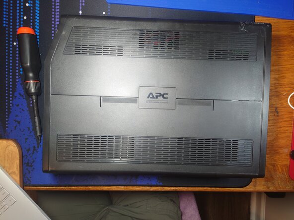

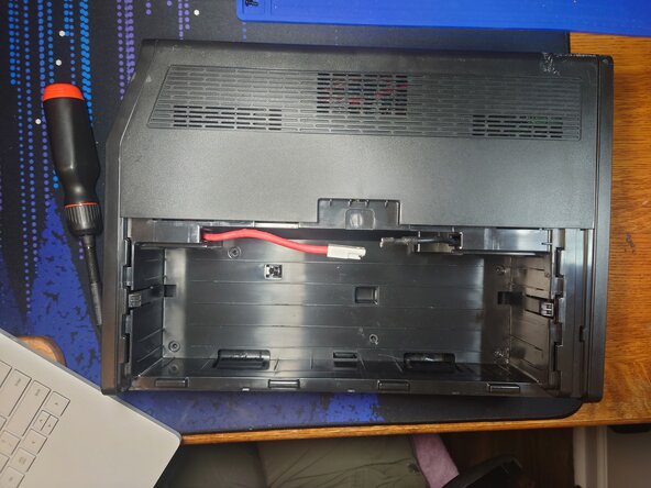

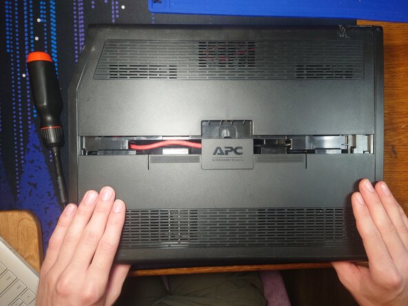

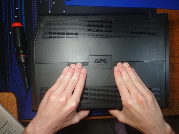

  2. APC Back-UPS Pro 1000 S Teardown, Remove Battery Cover: crwdns2935265:02crwdnd2935265:01crwdnd2935265:03crwdne2935265:0 APC Back-UPS Pro 1000 S Teardown, Remove Battery Cover: crwdns2935265:02crwdnd2935265:02crwdnd2935265:03crwdne2935265:0 APC Back-UPS Pro 1000 S Teardown, Remove Battery Cover: crwdns2935265:02crwdnd2935265:03crwdnd2935265:03crwdne2935265:0
    • Lay the UPS on its side. (Validate the orientation using the picture)
    • Push down hard on both sides of the APC logo.
    • Pull the slide cover towards you to remove.

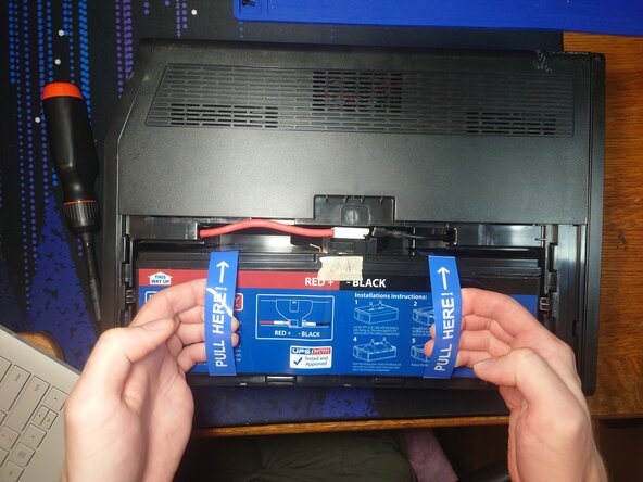

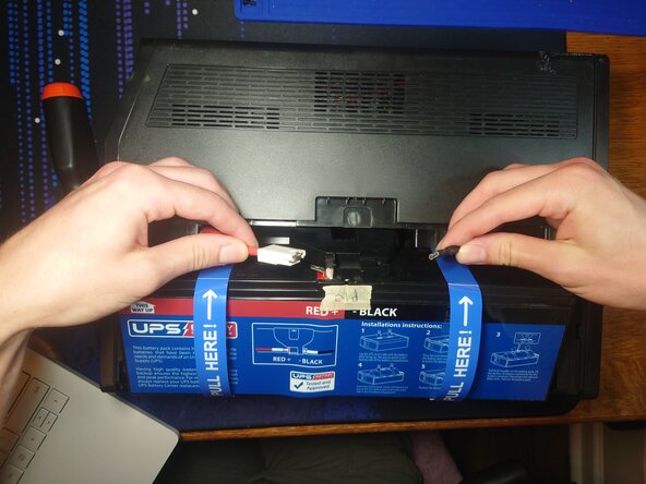

  3. APC Back-UPS Pro 1000 S Teardown, Remove Battery: crwdns2935265:03crwdnd2935265:01crwdnd2935265:03crwdne2935265:0 APC Back-UPS Pro 1000 S Teardown, Remove Battery: crwdns2935265:03crwdnd2935265:02crwdnd2935265:03crwdne2935265:0 APC Back-UPS Pro 1000 S Teardown, Remove Battery: crwdns2935265:03crwdnd2935265:03crwdnd2935265:03crwdne2935265:0
    • Pull on the battery pull tabs with the cables still attached. (In the picture the cables are already disconnected)
    • There should be enough slack in the cables to set the battery back down at an angle. This will let you access both cables.
    • Unplug both cables. Preferably unplug red first.

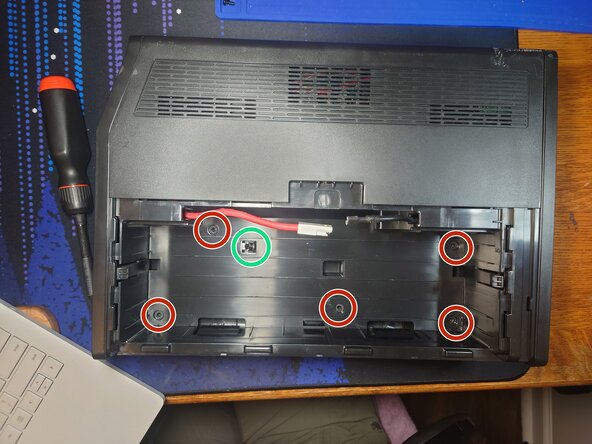

  4. APC Back-UPS Pro 1000 S Teardown, Disassemble Battery Comparment: crwdns2935265:04crwdnd2935265:01crwdnd2935265:01crwdne2935265:0
    • Remove the 5 phillips head screws in the battery compartment.
    • The black component (circled in green) is a temperature sensor. It can be left alone.

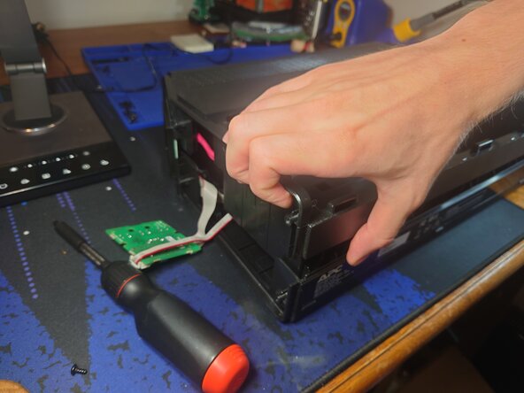

  5. APC Back-UPS Pro 1000 S Teardown, Remove Face Plate: crwdns2935265:05crwdnd2935265:01crwdnd2935265:03crwdne2935265:0 APC Back-UPS Pro 1000 S Teardown, Remove Face Plate: crwdns2935265:05crwdnd2935265:02crwdnd2935265:03crwdne2935265:0 APC Back-UPS Pro 1000 S Teardown, Remove Face Plate: crwdns2935265:05crwdnd2935265:03crwdnd2935265:03crwdne2935265:0
    • Turn the UPS so the screen faces you.
    • Stick a spudger in the cutout (outlined in red) to release the plastic snaps.
    • The snaps are firm so take your time and work your way across each edge.
    • Remove the 6 phillips head screws (circled in red).
    • Pull the face plate toward you to remove. It should take very little effort to remove.
    • The buttons are captive and will not fall out.

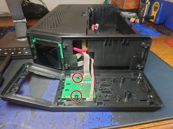

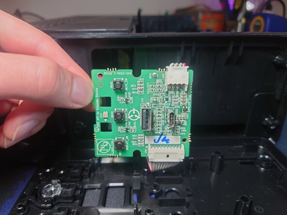

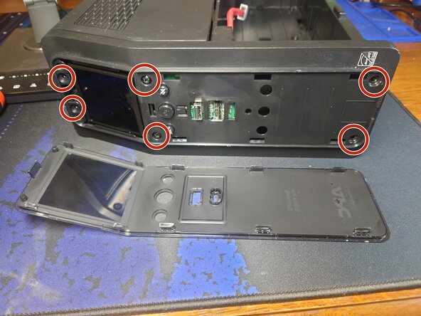

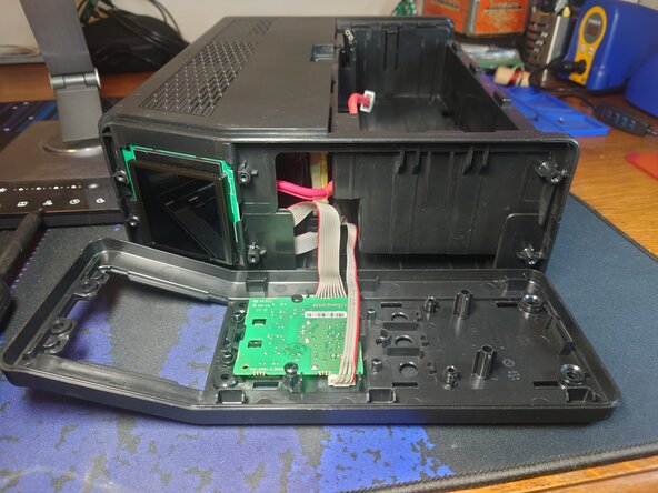

  6. APC Back-UPS Pro 1000 S Teardown, Disassemble Face Plate (optional): crwdns2935265:06crwdnd2935265:01crwdnd2935265:02crwdne2935265:0 APC Back-UPS Pro 1000 S Teardown, Disassemble Face Plate (optional): crwdns2935265:06crwdnd2935265:02crwdnd2935265:02crwdne2935265:0
    • Remove the two phillips head screws (circled in red).
    • These are a different size than the previous screws!
    • Lift the low-voltage circuit board to remove it. Note: It pivots at the bottom.
    • You may remove the connectors on the circuit board. Refer to this guide for removing connectors: Recognizing & Disconnecting Cable Connectors

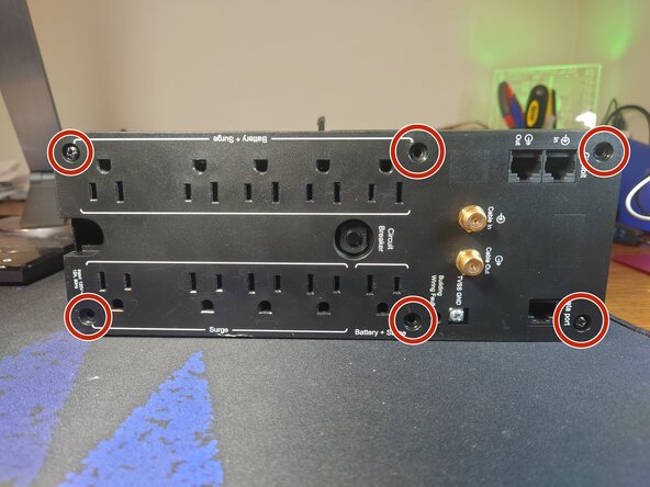

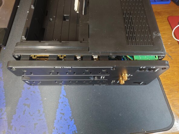

  7. APC Back-UPS Pro 1000 S Teardown, Remove Back Plate: crwdns2935265:07crwdnd2935265:01crwdnd2935265:02crwdne2935265:0 APC Back-UPS Pro 1000 S Teardown, Remove Back Plate: crwdns2935265:07crwdnd2935265:02crwdnd2935265:02crwdne2935265:0
    • Turn the UPS with the back facing you.
    • Remove the 6 phillips head screws.
    • Pull the backplate towards you to remove. It is connected to many wires and could take some effort to get loose. You cannot fully remove it.
    • Do not touch any exposed metal since it is connected to the high-voltage circuit board.
    • The back plate just needs to be about a centimeter away from the rest of the shell.

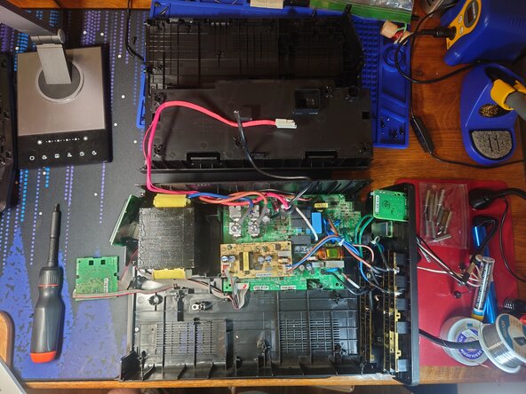

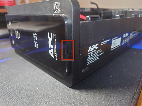

  8. APC Back-UPS Pro 1000 S Teardown, Remove Side Plate: crwdns2935265:08crwdnd2935265:01crwdnd2935265:03crwdne2935265:0 APC Back-UPS Pro 1000 S Teardown, Remove Side Plate: crwdns2935265:08crwdnd2935265:02crwdnd2935265:03crwdne2935265:0 APC Back-UPS Pro 1000 S Teardown, Remove Side Plate: crwdns2935265:08crwdnd2935265:03crwdnd2935265:03crwdne2935265:0
    • Turn the UPS with the battery compartment facing you.
    • Insert a plastic spudger into the bottom middle hole (outlined in red) to separate the plastic snap.
    • There are no high-voltage components in this area.
    • Pull up on the plastic shell to release it.
    • There are small plastic snaps at the top of the UPS but pulling hard enough should release them without breaking.
    • Once the shell is free, remove the cables from the battery compartment. The red wire may take some wiggling but it will fit through the hole.

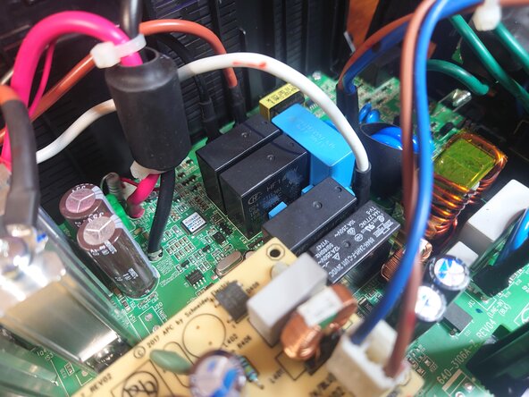

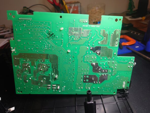

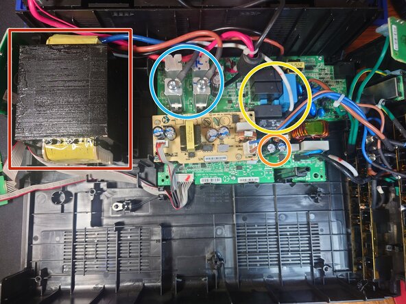

  9. APC Back-UPS Pro 1000 S Teardown, Inspect Circuit Board: crwdns2935265:09crwdnd2935265:01crwdnd2935265:02crwdne2935265:0 APC Back-UPS Pro 1000 S Teardown, Inspect Circuit Board: crwdns2935265:09crwdnd2935265:02crwdnd2935265:02crwdne2935265:0
    • ⚡ Wear high-voltage PPE for any further disassembly.
    • The transformer (outlined in red) can seriously electrocute you. Do not misuse it.
    • Be careful with the 400v capacitors. (circled in orange)
    • The metal towers (circled in blue) are heat sinks for mosfets. The mosfet part number is: IRFB7440 IOR P806J JK GO. These can explode under use and trigger an F02 error on the unit.
    • The relays (circled in yellow) can break which will also cause an F02 error on the unit.
    • The bottom of the circuit board cannot be accessed yet. The picture fit better here than the next step though.

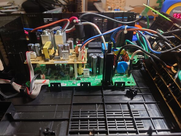

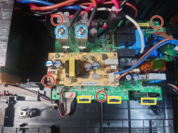

  10. APC Back-UPS Pro 1000 S Teardown, Remove High Voltage Circuit Board: crwdns2935265:010crwdnd2935265:01crwdnd2935265:03crwdne2935265:0 APC Back-UPS Pro 1000 S Teardown, Remove High Voltage Circuit Board: crwdns2935265:010crwdnd2935265:02crwdnd2935265:03crwdne2935265:0 APC Back-UPS Pro 1000 S Teardown, Remove High Voltage Circuit Board: crwdns2935265:010crwdnd2935265:03crwdnd2935265:03crwdne2935265:0
    • Unplug all wires from the circuit board. Some are very difficult to remove.
    • You cannot remove the thick black and red wire without desoldering.
    • Unscrew the 2 Torx T25 screws (circled in blue) on the metal posts to remove the wires.
    • Unscrew the 4 phillips head screws (circled in red).
    • Release the plastic snaps (outlined in yellow). You may need to pull up on the board to keep the snaps released. The board will pivot at the top.
