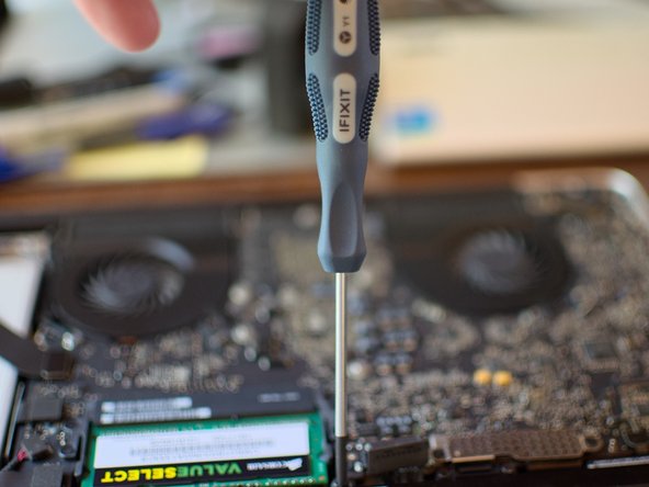

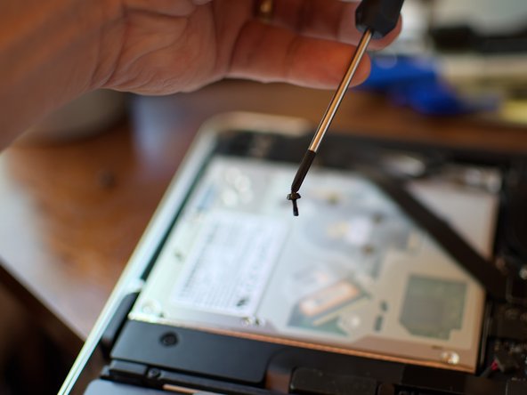

My Late 2011 MacBook Pro 15" started displaying "Service Battery" in its battery status a few months ago, but I decided to ignore it since my MacBook is almost always docked. But its fan runs too often and too long, and I heard that removing the battery will reset the MacBook's thermal management system, so I decided to give that a try. Much to my annoyance, I saw a number of tri-wing screws holding the battery down. iFixit to the rescue!
Following the iFixit MacBook Pro 15" Late 2011 Battery Removal guide, and using the iFixit Spudger and Y1 Tri-wing Screwdriver, the battery removal went without a hitch. Even with a tri-wing screwdriver, though, getting a grip on a tri-wing screwdriver is still a pain; nasty little fasteners, those.
Make sure to align the blades of the Y1 Tri-wing screwdriver with the slots in the screw head, then seat it firmly before you apply torque. The screw head seems to be very soft, and there's a dab of Loctite on the tip of the screw, and it feels like it would be easy to shred the screw head while trying to get it to start turning.
