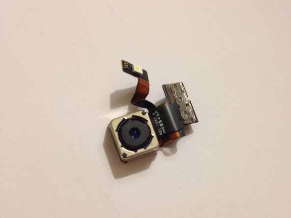

My iPhone camera would no longer focus.
More involved then I expected but went well. I had to open it up a few times to re-seat the front assembly cables.
Don't worry too much about getting the flash seated properly when the camera is first placed. What until placing the logic board bracket (Step 16) to shift the flash into the right position.
