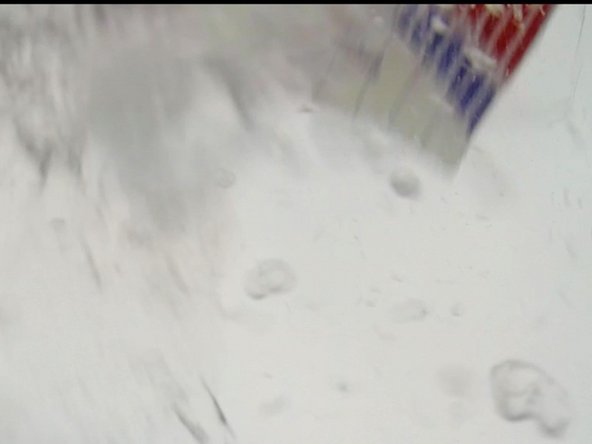

-Replaced a dead battery and powered up (Everything Worked???, except noticed an internal smudge)
-Found iFixit.com and the GoPR0 Hero 3 teardown
-ordered up tool kit and found a supplier for DSLR Sensor cleaning kit.
-Tore it down, gently cleaned the sensor, reassembled to find it now more of an out of focus looking smear, all was working fine.
-Tore it down another level, cleaned the sensor and the internal lens. Reassembled and BINGO... CLEAN Video and Pictures, except Now the two front LED indicator light don't work. Hmmm it has other lights so I'm good with this until I see someone else post how I might repair the lights. At this point I think it would require replacing the entire circuit card.
I was surprised that the flush and rice worked. Also my initial (recommended) gently wipe was not enough for the stain on my camera. I stripped one of the screws holding the the lens on the circuit card. I was pretty rough at that point trying to get traction on a stripped screw. I am pretty certain that has cause my new problem with front indicator led lights.
