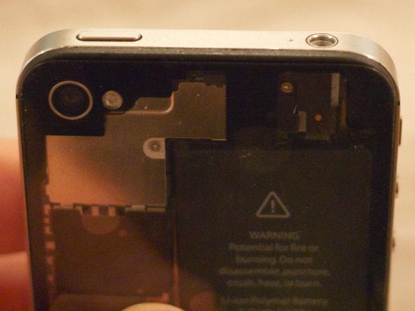

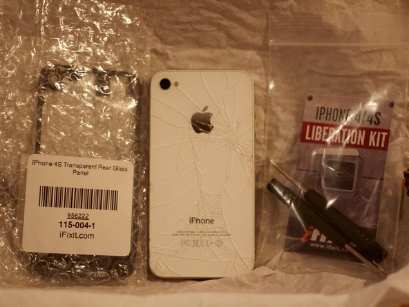

The back cover fell and fractured. I thought it'd be expensive, I was completely wrong.
Everything went smoothly except for the final slide. I was advised by support that I should use a table corner to push the new back the extra mm or two because I couldn't slide it with my hands.
It took some pushing but the back slide on and all is great now.
The video instructions may not be accurate so look around for the plastic cover over the camera area. Mine was on the inside, not the outside.
