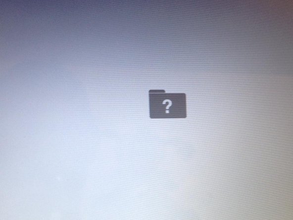

My computer was acting very strange ,slow,freeze up, so I tried my disk utility to check the HD and it told me to replace it. I backed it up to Time Machine App and replaced the HD. After the install of the new HD I could not get the computer to see the new HD for the restore. Option+R nope Option+C nope Option nope. I was frustrated. Went to Apple and bought a new 13 Mackbook Pro Retina."I use my computer for work and could not have it down thats why the rush to get anew machine" Nice machine. My old 2009 mac sitting in the closet was still on my mind, with a google search and then you tube i found "Ifixit" Now I have 2 MAckBook Pros. Lifes just not fair.
The rear was as easy as replacing the HD "Easy"
Easy fix $59.99 to fix a $1000 machine cheap
