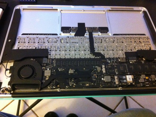

The MacBook Air I know audio no Wi-Fi and when you close the lid the Apple sign stayed on and if you would open you would have blank screen and if you had a close the fan stay Run until the unit would run out of battery I thought purchase a problem machine
The Wi-Fi did not have wires attached to it replaced i/o board and correct problem with OS works beautiful
Use the 54 bit driver set and two of the spudger that works really really good thank you very much
