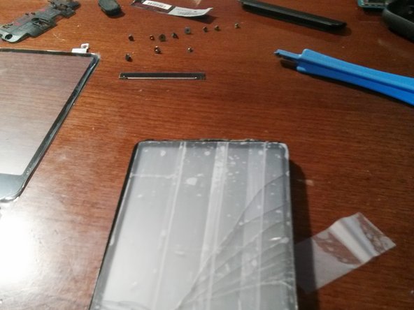

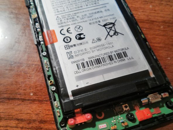

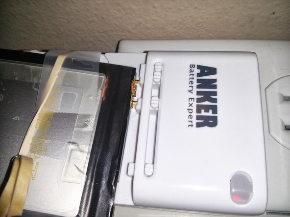

There were 2 phones that needed to be fixed. One with a broken screen and the other was bricked. The broken screen is self explanatory. The bricked device was a Motorola Droid Razr Maxx. He bricked it to where it wouldn't charge. So eventually the phone just died. I could get enough power in it to start it up and get to the fastboot screen, but that's it. Everything I could get it into wouldn't charge the phone. I had to tear it down, and manually charge the battery in order to use fastboot to restore the phone to stock.
Great. Bricked phone is no longer bricked. The broken screen is no longer broken
Buy a heat gun if you're messing with a screen. Take more pictures.
