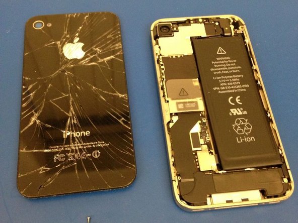

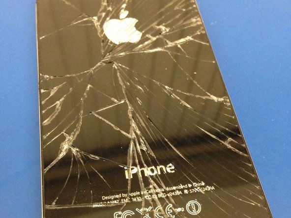

One of my employees dropped their phone and shattered the rear glass panel.

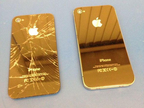

This has got to be the easiest iPhone 4s repair possible. Two screws, remove the old panel, give a quick blow with some canned air, install the new panel. Took all of about 5 mins.
Make sure you order the right part! I accidentally ordered the iPhone 4 rear glass panel and realized I should have ordered the iPhone 4s rear glass panel. They are not interchangeable. Duh!
