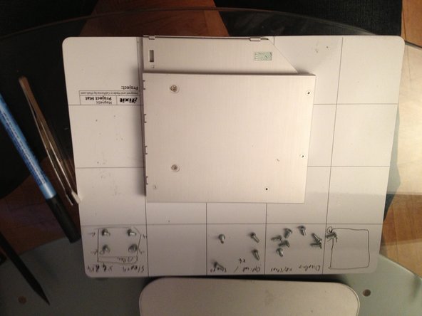

i had the possibility to fix the ssd with 2 screw on the backside of the Optical Bay, so i did.
I was not able to put back the last screw of step 15 ( Installing iMac Intel 27" EMC 2309 and 2374 Dual Drive ) on the optical bay.
A little pain about reconnecting the optical sensor in the good way.
I disassembly the computer up on his feet, but for put back the screen, I had to put the computer down Because, the screw holes was not aligned correctly due to the weight of the screen.
the vertical sync ribbon cable is the main tricky part of the reassembly. It's hard to reconnect it.
I loved the Magnetic Project Mat ! So use it !
