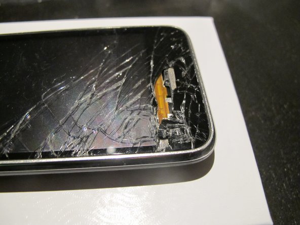

The digitizer was broken, but LCD works fine

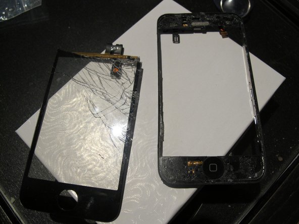

This went very vell! The tools supplied was long and made it easy to handle. Took me about an hour to repair it. The most time consuming part was to get all the old glass off the frame, but with good heat it came off fairly easy.
The best thing you can do is warming up the glass before you try to remove it. To start I found it easiest to begin with the side. Just pull the frame out so you separate the frame and the glass and put the plastic pry-tool in between. Drag it to one of the sides, and heat well!
