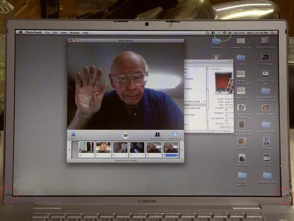

I used some transparent shipping tape on the front of the bezel to hold things together temporarily and then carefully snapped and screwed the top cover back on. I then reinstalled the whole top assembly following the guide step-by-step in reverse order. When that was complete I fired up the computer and was somewhat amazed that everything worked. All of the electronics in the display operated as designed: the bluetooth radio connected to my external Mighty Mouse, the WiFi connected to the internet, and the iSight camera worked. See Pict0003. Only on the display screen itself could other problems be observed. There a several noticeable artifacts such as dust and white spots on the edges of the which detract from the appearance of the display without affecting function except in the case of critical graphics applications. If it were not for the broken bezel, I would have called it Good Enough and given up.
