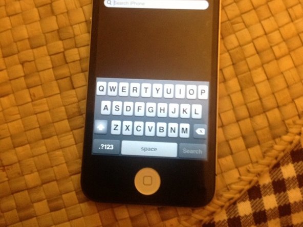

The home button on my iPhone 4 was flakey. Apparently, a common problem. I was holding out for the iPhone 5 announcement, and was somewhat underwhelmed. Once I finally decided NOT to upgrade, I knew I had to fix/replace my home button. Since I was going to replace it, I was going to make my phone unique so I got a white button for my black iPhone.

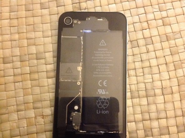

I also picked up the transparent rear panel because, why not? I _SAVING_ money by not buying an iPhone 5, right? ;-)

However, their instructions did not lead me astray. Following the guide got me to the home button with no surprises or extra work. Now my iPhone is a) functional, b) multi-colored and c) transparent!
Pulling the display from the metal case was a lot harder than they made it sound. It was basically as described, but the fit was so tight that the iPod Opening Tool didn't want to slip in there. I ended up having to sacrifice a bit of scratching on my phone and use a very fine metal screwdriver to get between the plastic gasket thingie and the metal frame.
I would also recommend the magnetic screw mat for the task. These suckers are TINY, and it's not always easy to remember which one came from where. $deity help you if you drop one or accidentally knock it out of the way. I didn't have the magnetic screw mat and wish I did.
