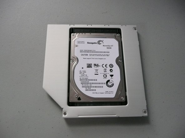

Placing the HD in the enclosure: I couldn't track down any actual directions for this. The video is terribly vague, and there doesn't seem to be any written documentation beyond replacing the optical drive. What I did: slot in the drive, pop the plastic spacer in behind it (words up), and use two screws in the bottom. It came with four screws total, leaving me with two spares and making me nervous, but I have no idea what else to do with them. See photo.

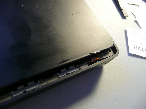

Step 11 (lifting the upper case): Be careful! The front edge of my upper case cracked/splintered right along the edge. A little epoxy seems to have fixed it up well enough, but it's a repair I wish I didn't have to make. See photo.

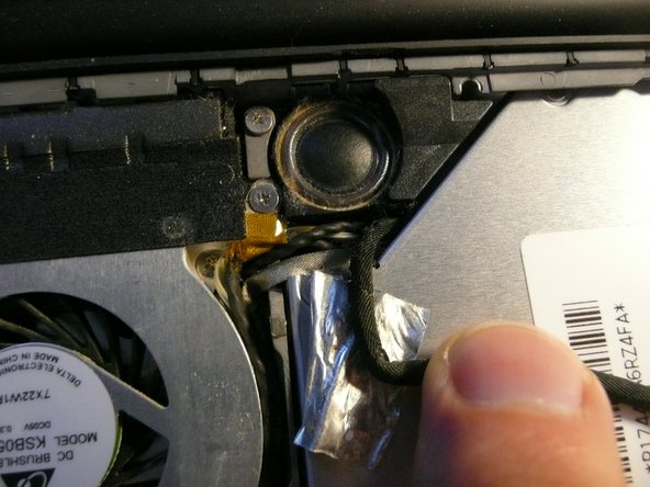

Step 20 (removing optical drive screw): First, there's not just the bluetooth cable: it's a rat's nest over this thing. It took me a few minutes to figure out what the picture was referring to, because I couldn't even see a screw at first. I used the pointy end of the spudger to hold everything to the side. Be extra careful when you remove the screw, cause if it gets lost below the cables, you'll be cursing. See photo (the screw's hiding under all that wire.)
Also in that step, replacing this screw is --why-- you leave the bracket loose in step 29 when you replace it. The hole in the bracket didn't line up for me when I replaced the drive, and I had to loosen the bracket to let the hole slide back into place. Still took some convincing with the spudger, but it --does-- slot back into place.
