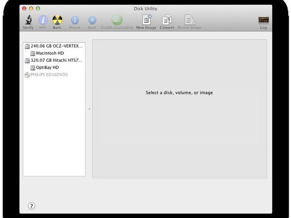

After upgrading my macbook to Lion, my superdrive started to work in a fancy way, and stopped burning disks. To repair it I was asked a lot of money, so I decided to replace it with something more useful, like a secondary hard disk.
The repair was smooth, if you are new to opening your precious mac, you need to keep calm :) breath slowly and don't panic!
So what I did was: replacing the old hard disk with an SSD; replace the Superdrive with the old hard disk; in this way I keep my photos and music out of the SSD.
And since I was there, I replaced my old 4GB RAM with 2x Corsair Ddr3 1333Mhz 4Gb 204 Sodimm, which on Amazon costed me less than 40 euro.
Now my MacBook Pro looks like new!
