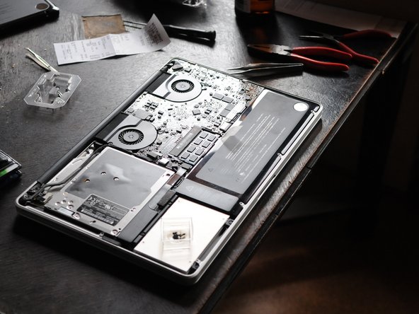

after nearly 900 cycles (coconutbattery) Accu asks for service. Besides the MBP starts to having problems with low Accu, sometimes it was unable to write the memory content down to SSD
Repair was smooth. Instead of buying a pentalube screwdriver (which you'll never need again) I loosened these screews with an engineers pliers as displayed in the picture. After replacing the Batterie I slotted the screw heads as in the second pic
