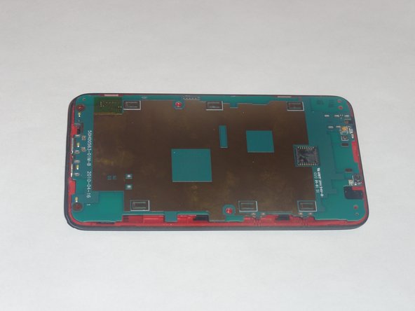

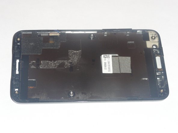

The basic dis-assembly steps went smoothly. I had all the tools and skills for the task. The preliminary steps took only 15 minutes.

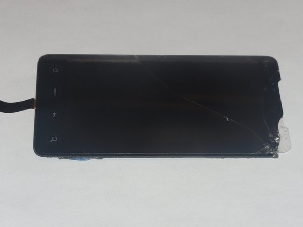

The last step of the dis-assembly was heating the glass to loosen the adhesive and gently prying it away from the bezel and the screen. Despite my patience and over 1 hour of heating and gently prying, the screen stayed adhered to the glass and eventually cracked as I was prying it out of the case.
My best guess is that I simply didn't heat up the adhesive hot enough or long enough. My main concern was not melting any plastic part that I needed to retain.
