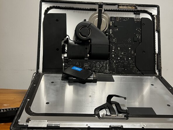

Once I had the top and side adhesives cut, I could finally see inside. I used the same flat metal tool to unlock the display cable’s latch without opening the screen fully, and then I carefully detached it. I also removed the FaceTime camera cable. My hands were shaking with excitement—this was something I had planned to do for so long, and I had finally gotten to this point without breaking anything.
Next, I laid the screen flat on the desk with the suction cup handles holding it. I unscrewed the hard drive and set it aside. But the SATA cable was ridiculously short and very tight. I couldn’t fit my SSD in that small space. I figured maybe if I unscrewed the speaker, I could make a little room. I removed the speaker screws and tried to lift the speaker just enough—but it wouldn’t come out entirely. I struggled quite a bit, but still couldn’t get enough space to connect the SSD.
Eventually, I gave up and decided to remove the speaker completely. It didn’t want to come out easily either. But after more pushing and pulling, I finally managed to plug the SSD into the SATA cable. I didn’t screw anything back in yet—I just wanted to test it before reassembling anything.

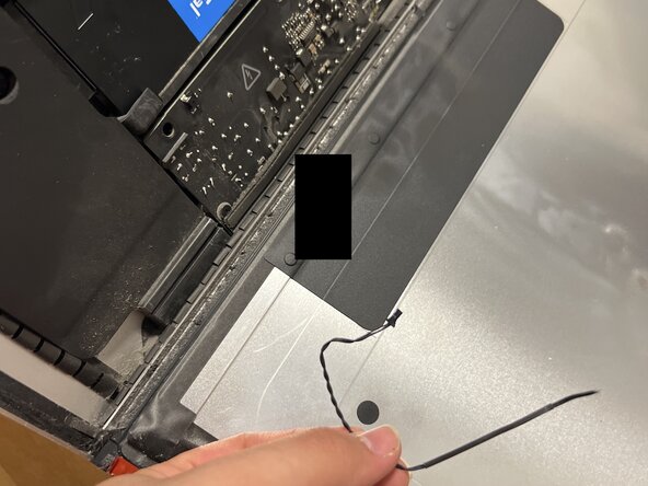

I plugged in the iMac and… nothing. No sound, no fan, no lights. My heart dropped. I thought I had broken something. I unplugged it immediately. Then I remembered a YouTube video that mentioned how a torn power button cable could prevent the board from powering on entirely. I looked—and sure enough, the cable was ripped out from the back of the button.
I removed the torn cable from the board and plugged the iMac in again. This time, one of the four diagnostic LEDs on the logic board lit up—the one that indicates the PSU is working. That gave me hope. Carefully, using a flat metal tool, I shorted the two pins behind the power button socket, and to my amazement, the computer turned on!

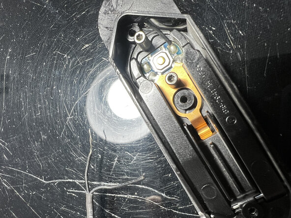

Now I had to fix the power button. To remove it, I had to fully take out the speaker (which meant also removing the fan). Once I reached the power button area, I saw that it had a weird shape and was extremely well glued. I heated it with a hairdryer for a few minutes, then slowly pried it out using the same flat metal tool. Finally, I grabbed it with pliers and pulled it free. It had two tiny screws, which I removed to expose the torn cable.
I tried to reconnect the wires myself using basic tools, but it didn’t work. Since I don’t have a soldering iron at home, I took the button to a local phone repair shop the next morning and asked them to solder it back for me.
As soon as I got home, I plugged it back in and pressed the button—and it worked! I was overjoyed. Now came the challenge of placing it back without putting tension on the cable. I tried using double-sided tape to stick the button into its place, but when I reinstalled the speaker, I noticed the button was being blocked and didn’t click properly.
I removed the tape and carefully positioned the button into place without adhesive—just sitting loose but aligned. It worked fine that way, and when I reinstalled the speaker, I could press it normally. The speaker didn’t sit perfectly flat at first, but I pushed it down gently while aligning the screw holes and tightened it slowly. This time, I was extremely careful with the power cable routing.
