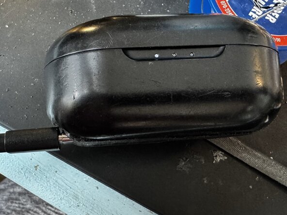

Most of Jlab's wireless earbuds have a dangling USB-A cable that is permanently attached to the case. This is a nice feature to have as you don't need to carry a charging cable (only a charging brick or a device sporting a USB A port). However as soon as this cable is worn out mechanically, for instance by the daily bending of the cable that is required to use it, the charging case becomes a paperweight. The cable itself isn't available to order, which is to be expected from less than €30 earbuds.
This repair was a an excellent excuse to use my new 3D-printer. I measured the dimensions of the cable slot as precise as possible with a set of calipers, and made a cad drawing with OnShape. If found some hand-solder friendly USB-c ports on AliExpress and designed the wiring enclosure around that. I had to print and adjust the cad file a few times to make it fit into the cable slot. The end result is ridiculously elegant, and it even complies with EU regulations!
As expected, this took more time than planned, and could easily be done with some glue or epoxy around the wires and usb-c port. But it was good exercise in designing parts that fit onto commercial devices. The cheapest way to handle this repair would be just to replace the cable with a USB A part of a broken charging cable. That way it can even be considered upcycling.
