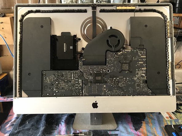

Failed hard drive. Replaced with SSD.
Fairly tedious. Made sure to clean any leftover adhesive from original adhesive strips with rubbing alcohol. Took my time and got the display perfectly centered.
BUY THE CUTTING TOOL FROM IFIXIT. It also helps to have a spudger to remove the original adhesive strips. The service wedge kept everything nice and stationary.
