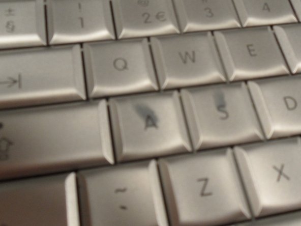

There were wear marks on the "a", on the "s" and on the "n". I had probably typed with dirty hands. I was so ashamed about the rudeness, or is it sloth, I had done to my beauty, I had to repair.

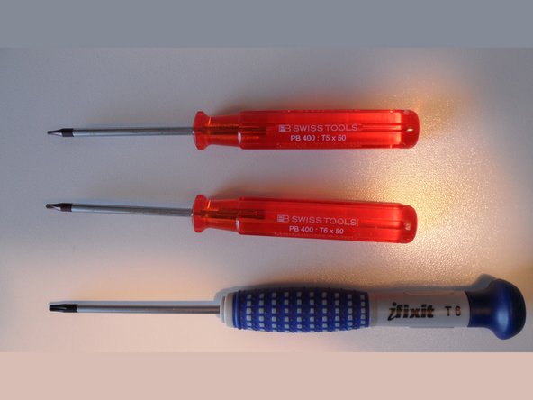

You sent me not a T6 Torx screwdriver, but it was a T8, as I could assess in the tool shop I went to the next morning, after the first night I wanted to spend on the repair. Look at the photos.
So this night I had to do something else. The next morning I bought a T6 Torx screwdriver, and a T5, to be absolutely sure I would encounter no more obstacles. There is a photo of the three screwdrivers.

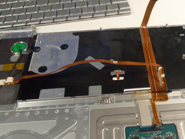

How to get the ribbon off the motherboard without damage? There was a translucent orange tape on the spot the ribbon was fixed to the motherboard.
I pulled it off, and off came a square of soft black rubber with the tape. O my God! But it was just some rubber. I carefully pulled the ribbon out of the motherboard, out of a little black rectangle.

I went on, and learned by carefully poking with the fine tip of the spudger how you can unloose the things you call "the flap" which fixes a ribbon to a connection. I was not yet familiar with this kind of connection, so, it was adventure again.
I had to unloosen ribbons that were glued to the surface, by carefully poking with the flat end of the spudger. Again, some excitement here.

Be more careful about sending the right equipment, don't send a T8 Torx screwdriver instead of the right one, the T6.

The long thin ribbon carrying the sleep signals is glued to the surface. That could be mentioned. In the photo below it is unloosened.
