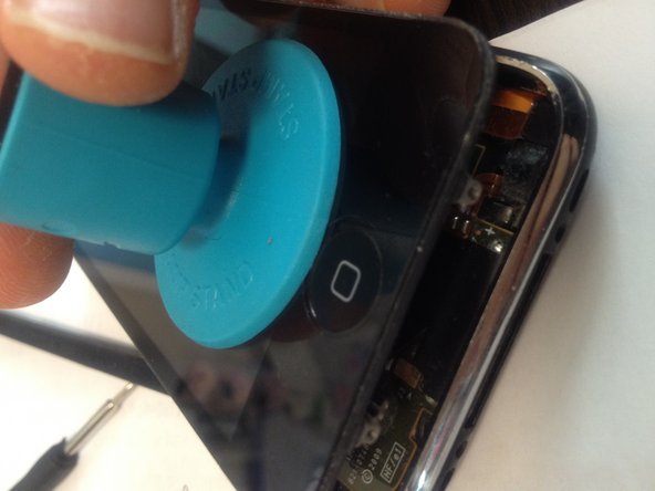

Suction Cup can be substituted for your any suction cup.
I purchased in the 100-yen shop, not iFixit.
(See a photo. I bought blue one. It sales "Stamp Holder" in DAISO Japan, but can use as suction cup. It is easy to hold a suction cup than Suction Cup what selling iFixit.)
So, if you can go to shop and buy like it, cheap than buy from iFixit. You can save your money.
