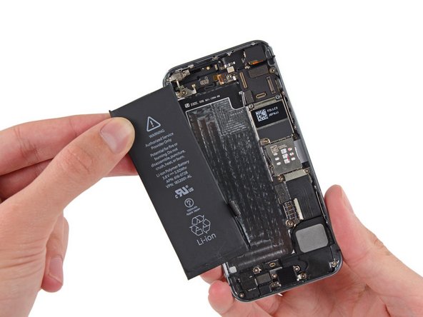

iPhone would suddenly shut down although battery was still 10% and also the battery was getting empty really quick.
The repair went well, except the removal of the battery itself. The adhesive did break, luckily only on one side but still it was quite a hassle. The tip to use dental floss in addition to the card was very helpful. It prevents one from bending the battery too much.
Give it enough time!!! As soon as you start to hurry and use too much force, things will get worse.
