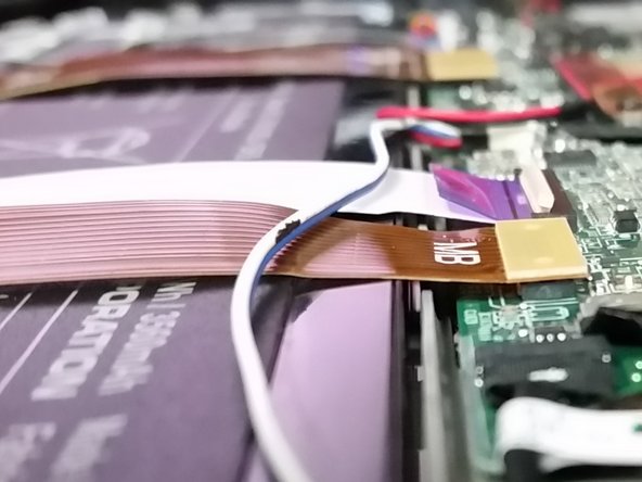

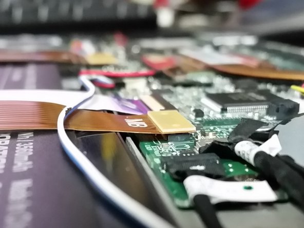

When the screen was moved or re-positioned, it went blank.
Using the iFixit guide I was able to see how to take the back cover off. I noticed that the clip to secure the video cable was un-secured and pointed up instead of down and clicked. I re-positioned the clip to hold the cable in place and reassembled the unit.
I was able to eliminate the cost of a new $800 machine. With guides like this for the benefit of the DIYer it makes it easy to move through a repair.
