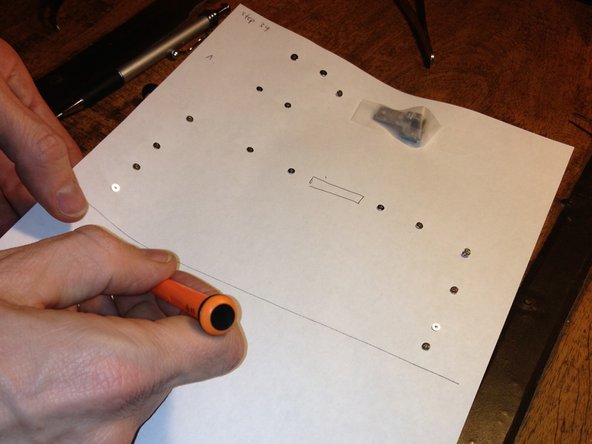

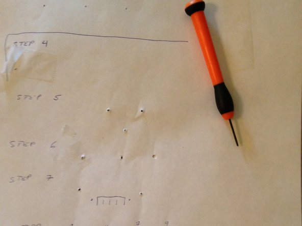

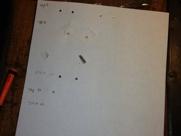

My Mac-experienced friend who helped with the repair used a simple but effective way to keep track of the different screws during the disassembly. For each step requiring screws to be removed, we labeled the step on a piece of white printer paper, then made small holes in the approximate location for each screw. Several steps can be put on one piece of paper. The screws are pushed into the hole in the paper using the magnetic screwdriver. For the holes, I used the smallest screwdriver I had. Put the holes in before taking the screws out! I used small tabs of scotch tape to hold the ultra thin screws in the hole. This takes all of the guess work out of the reassembly and keeps everything organized!
