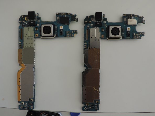

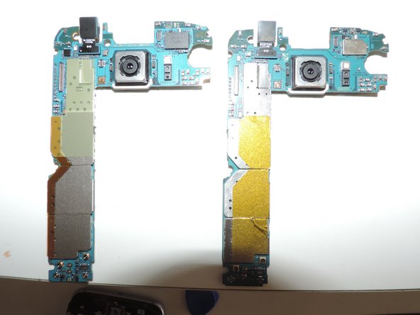

I was taking apart 2 Samsung Galaxy S6 phones--Sprint and Cricket. I tried to sell my Cricket phone to Gamestop and they told me that they do not accept Cricket phones because they have cheaper phones. The associate explained that they use more plastic in their parts than metal.
I compared both and the Sprint phone has a slightly heavier weight, and the inside parts are definitely different.
(Left motherboard is Cricket and right motherboard is Sprint)
When I opened up the Cricket phone at step 30 (removed the front display, the glass cracked apart the black midframe--the phone's designed is a little different. But when I did the same dis-assembly for the Sprint phone, I could follow all the steps perfectly.
The guide should add some caution for taking apart a Cricket phone, the inside parts are slightly different (refer to the photos posted). But this guide is perfect for any other phone!
