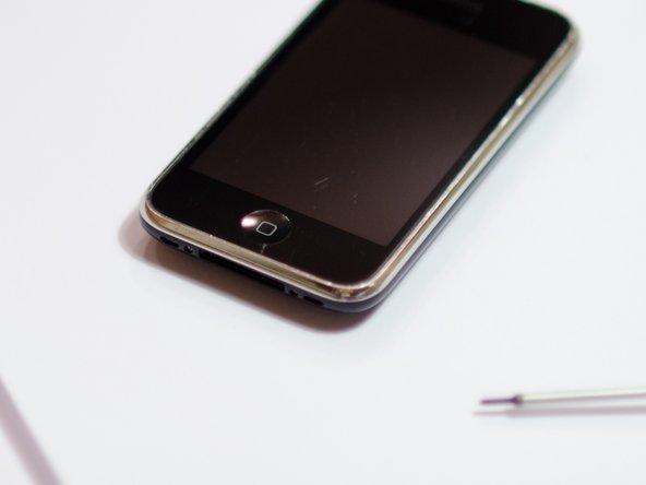

During the call phone buzzes (noise like when you telephone near speakers)
Home button was getting more and more 'stubborn'
Plus about half a year ago it fell down and glass was broken near home button. And all the scratches started to annoy a bit
First of all I should say that this was new experience for me, but I like to do things where you need accuracy and handiness, so I thought to give a try (it would be too expensive to get service and you'll never know what you'll get back /in my country/)

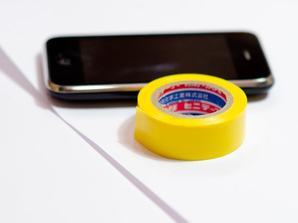

Many written before, but one more:
original dock on contacts had some tape on it, so i asked dad to give me some and put pieces too. The same with home button. It looks more hermetic for me - if youd look in light youll see some space between dock connection and panel - cool way for dust to get in.
Wish you good luck as it happened to me - even working without all parts connected :)
