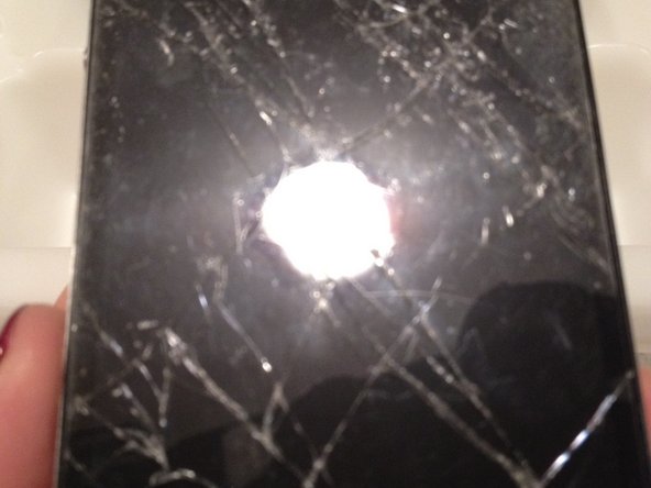

I dropped my iPhone4 while hailing a cab. It fell out of my pocket and onto the sidewalk. The entire front display was shattered.

What they do not tell you in the step by step repair instructions and video, is that if you have shattered the glass, there will be lots of pieces to remove when you get to the step of removing the damaged front display. This is the last step before putting the new display in place. It took me a while to remove all of the little pieces and I would recommend wearing safety glasses!

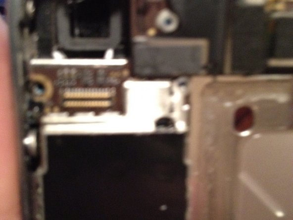

Be sure to keep track of the little rubber piece that lies under where the digitizer and LCD cables fold over the logic board. It will fall out when you remove the logic board. Also be careful when removing the battery. I tore a little piece of the outer covering close to the battery connector. It ended up to be fine, but Apple does add extra adhesive to make it difficult to remove! The pry tool really helps here.

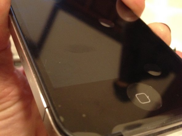

Overall, I found the repair to be straightforward when following the step by step process. With the right tools and patience, one should not have any issues.
