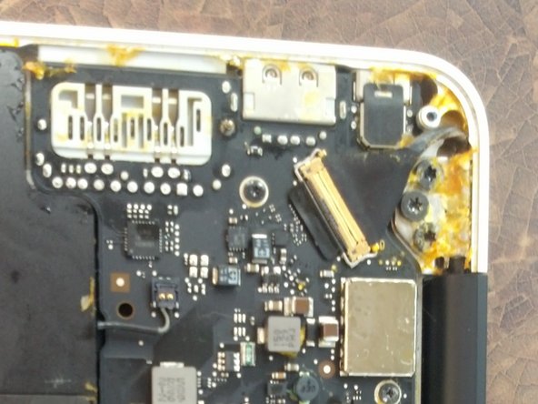

Spilled Fresh Squeezed OJ Spilled on my MacBook Air Keyboard
I followed the iFixIt guideline (flawless guide, BTW) and was able to remove the OJ/pulp from the internal parts and keyboard. I removed all parts from my MacBook Air and cleaned all with electrical cleaner and de-natured alcohol. All components re-assembled and working great. The ONLY indication of an issue is the keyboard lighting is slightly dimmer in the spill area.
