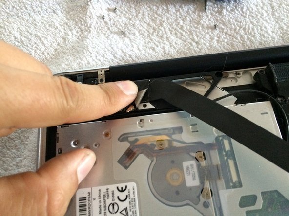

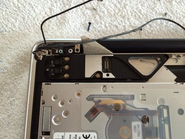

Wanted to enable Continuity on my 2010 Mac Book Pro 15" upgrading the BT/wireless card using a BCM94331PCIEBT4CAX and the 2011/12 Airport/BT Bracket
And the tool and guide from:
https://github.com/dokterdok/Continuity-...
Very well, both our 2010 15" Mac Book Pro's are now running with Hand off and continuity! :-)
Buy the 2011 Airport/BT bracket instead of trying to modify the old 2010 to fit the BCM94331PCIEBT4CAX.
