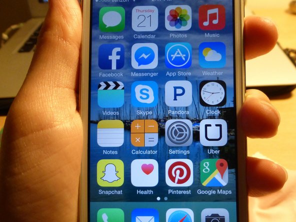

I was told that if I plugged my phone into my computer and the device wasn't recognized, my logic board was done for. Initially, this is what I thought happened but after charging for about an hour, the phone was recognized and it was turning on! Initially, it wasn't working well. The touch response was really bad and slow, the sound wasn't working at all and made gross, scratchy noises, there was a white splotch on the screen, a high pitched whining noise, and the phone was rebooting about every 5 minutes. I was quite disappointed but as my phone charged all the way, the sound problem resolved itself and just completely went away, eventually, the slow touch response also went away, as did the whining noise and the continuous rebooting. By morning, the white splotch on the screen was just gone and everything seemed back to normal!
It's been about 3 weeks since I put my phone together and everything's still working perfectly. The only thing that's different is that the battery loses charge pretty quickly and I have to charge it at least twice a day. For now, this hasn't been too much of a problem and maybe I just got a "bad" battery?

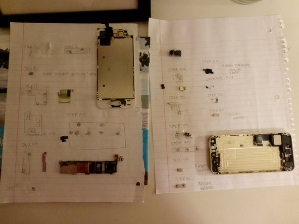

When taking apart my phone, I drew out each step that involved parts and screws and used double-sided tape to attach the pieces to the drawings so I'd know exactly where everything went on reassembly. This proved to be very helpful and I didn't lose anything/have any problems or confusion when putting it back together.
