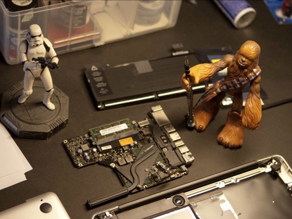

Anyway. When the power button was pressed nothing happened. Dead. No battery indicator of any kind. The brand new charger barely lit up with a faint green.
Decided to replace DC-in Board. Got it in. Everything went smooth. Got a charge light. Got a battery indicator. Got it turned on. Battery 100% charged. Unfortunately, a hodgepodge of keys on the keyboard are functioning improperly. This was probably the main problem all along because fiddling with the keyboard ribbon and using the power pads is what really seemed to get everything functioning back to normal (aside from the keyboard issue.)
The real issue? It's hard to tell if a case/keyboard replacement is all it needs, or if there are darker problems lying beneath the logic board? A wireless keyboard does work for now. There may also be a heat sink problem associated with this. The bottom case gets very hot only on one half of the laptop...the logic board/heat sink side.
