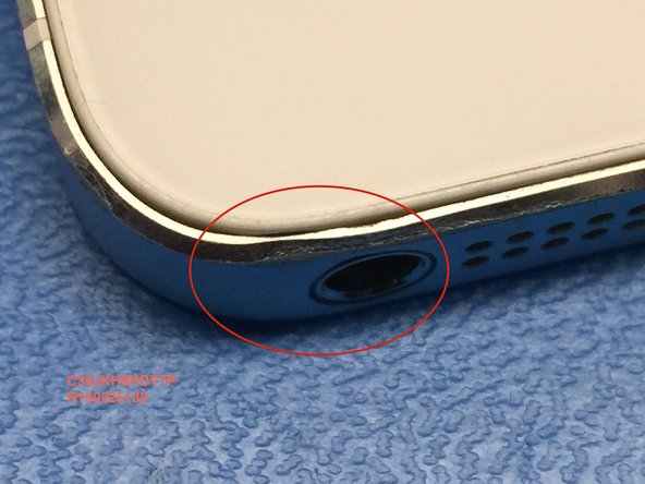

My iPhone 5 is one of the early models (Sept 2012) that have a manufacturing defect on both battery & power button. Apple acknowledged the problem and has a free repair program. My phone qualified for both battery & power button repair programs. However, Apple customer service denied "free" service, because my phone has a cosmetic dent in the frame next to the audio jack. Cosmetic = 0.3mm dent !!! See picture. Apple would still do the repairs, only I had to pay $279 + tax. Thank you so much Apple!! I really appreciate your help, but no thanks! So I decided to do the repair myself and involve my 5year old daughter in the project. She was thrilled :)
