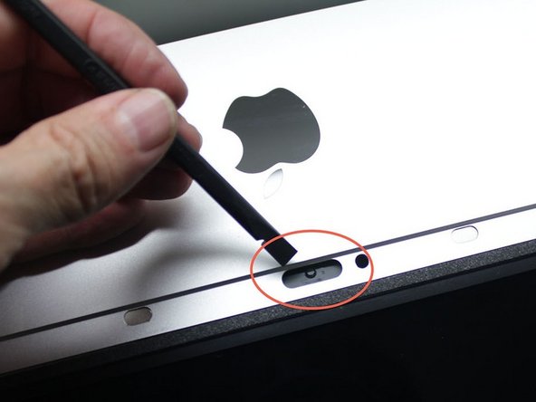

- Also, I meet a little annoyance when I was reinstalling the front aluminium bezel. It happens that the little luminosity sensor placed below the middle lower part of the screen was somewhat pushed out of place while placing the large bezel, and after realizing the issue I have to de-bend it and relocate with a spudger (photo 2). Maybe you can warn about it in your guide.

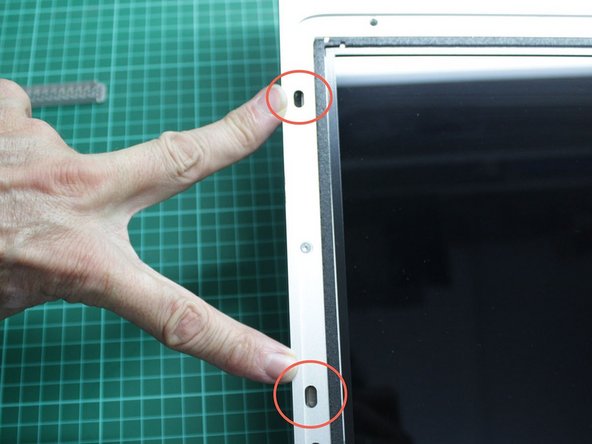

- Finally, I found missing a couple of the magnets of the bezel (photo 3): they have lost the adhesive which fixes them to the back of the bezel and ended up attached to the steel frame beneath. I have cleaned the old adhesive rests and replaced it with double sided thin tape trimmed to fit in their sockets. Umm... due to the little glueing surface, the smoothness of metallic parts and the (really) strong force of the magnets, I don't know if that shoddy work will resist if not maintained by the attraction of the metal strips in the back of the front glass panel. Any idea of a better suited adhesive?
