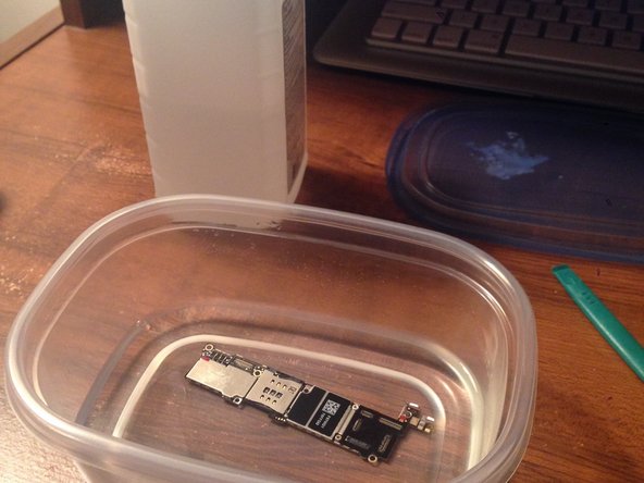

I only had 75% alcohol, but I cleaned up the corrosion with a q-tip and let the logic board soak for ~30 minutes and dry for 1.5 hours under a fan. When I put everything back together and plugged in the battery nothing happened, but when I plugged the phone in to power I heard the charge noise! It was showing up in iTunes, and I was able to restore the phone. Unfortunately the screen still wasn't working. I used a spare, broken iPhone 5S display to verify that it wasn't a problem with the logic board. It was really exciting knowing that I was able to bring this phone back to life. And then I broke everything again.
I tried taking apart the display to clean up the corrosion on those components as well, and I located some more corrosion on the Logic Board. So a bit more alcohol, and I let the log board soak again. This time I got impatient and only waited ~30 minutes after taking it out of the alcohol and drying under a fan to try putting it back together. I don't know if the alcohol was still present in the battery connector or what, but when I plugged in the battery and Lightning port to the logic board the speaker started making a static noise. It would stop if I disconnected either component, but I couldn't get it to show up in iTunes any more. After a couple minutes the static noise died, and I haven't gotten a peep from the device since. I let it dry for 3 days and tried putting it back together this morning, to no luck.
