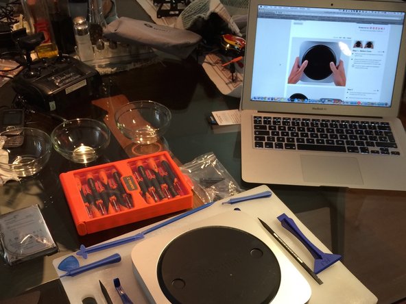

I only had the drive that came with mi Mini, I didn't go with the "server version" that has 2 drives, so I bought the iFixit kit to be able to install a second drive a SSHD
The repair was very easy with the guide, it took me 20 minutes to disassemble the whole Mini to get to the hard drive tray and install all and reassemble.
Make sure to buy the whole kit, without the Mac Mini Logic Board Removal Tool there is no way you can do this install without damaging the logic board
