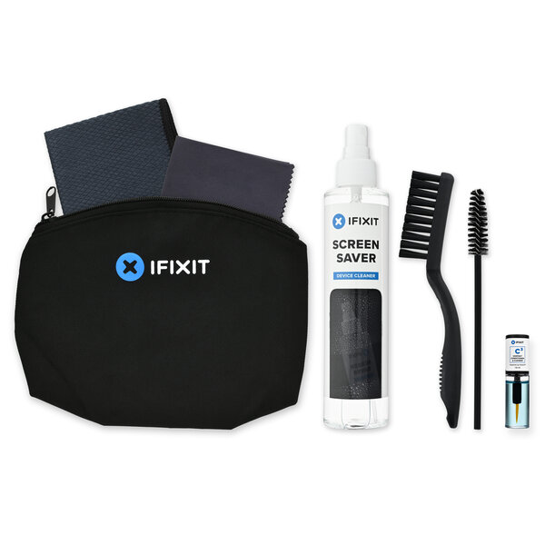

So, what’s the best way to tackle dirty or corroded contacts? We’ve got a precision cleaning kit with a bunch of tools to make it easy. For the cleaning fluid, you’ll want to use 90%+ isopropyl alcohol or specialized contact cleaner. Any time you’re cleaning electronics, it’s important to use isopropyl in concentrations of at least 90%, as anything less has enough water that it could cause more corrosion before it evaporates.
Cleaning corroded contacts will require opening up the console or cartridge, but don’t worry—chances are there’s an iFixit guide that can walk you through the process, be it for your cartridge or console.
