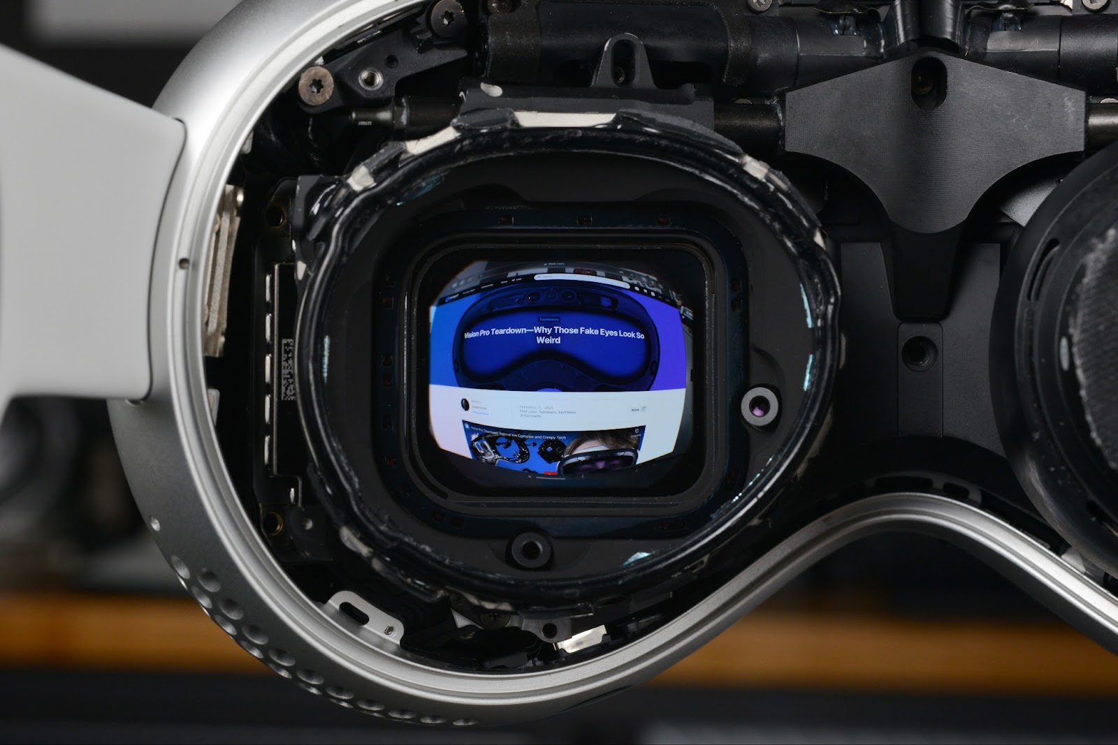

Each lens assembly has a pancake lens array, a housing with embedded eye-tracking cameras, and a display panel. The display panels are most likely made by Sony—possibly a custom version of their microOLED displays.
The display doesn’t light up from edge to edge, so we’re only counting the lit portion of each panel. The lit sensor area measures around 27.5 mm wide by 24 mm high, or about one inch by one inch. Using an Evident Scientific DSX1000 microscope, we measured the pixels at 7.5 μm (the size of a red blood cell). Each pixel is roughly a square: red and green sub-pixels stacked on top of each other, with a double-sized blue sub-pixel on the side. With those measurements, the lit area totals 3660 px by 3200 px. That equates to 12,078,000 pixels smushed into 0.98 square inches!
But the corners are cut off, so that reduces the pixel count even further. It’s asymmetrical, with triangular corner cut-off areas of 6.95 mm2, 11.52 mm2, 9.9 mm2, and 10.15 mm2, totaling 38.52 mm of deactivated screen. Compare that to the total area of around 660 mm2, and we see that the corners cut off 5.3% of the total, leaving 11,437,866 visible pixels per panel. Counting both panels and a margin of error on our side, that’s the 23,000,000 pixels Apple claims.
Divide those pixels by the length/width, and you can calculate the PPI (pixels per inch), which as mentioned is a measurement of pixel density. The Vision Pro comes in at a stunning 3,386 PPI. This, says Arthur, “is AMAZING PPI!” (his caps, not mine).
That many pixels must make the Vision Pro 4K, right? The horizontal resolution on the panel doesn’t quite make it to the consumer 4K UHD standard of 3,840 pixels wide. In short, this is a seriously high-res display. But it’s not technically 4K, which is why Apple didn’t simply call these 4K panels.
It’s certainly the highest-density display that we’ve ever seen. For comparison, the iPhone 15 Pro Max has around 460 PPI, which means you can fit ~54 Vision Pro pixels into a single iPhone pixel.
Or how about the 12.9-inch iPad Pro? That has 264 PPI, making the Vision Pro 12.8x finer. For a direct comparison to another VR headset, the HTC Vive Pro has ~950 PPI (4896 px × 2448 px), less than a third of the Vision Pro, and the Meta Quest 3 has ~1218 PPI. Don’t worry, it gets weirder.

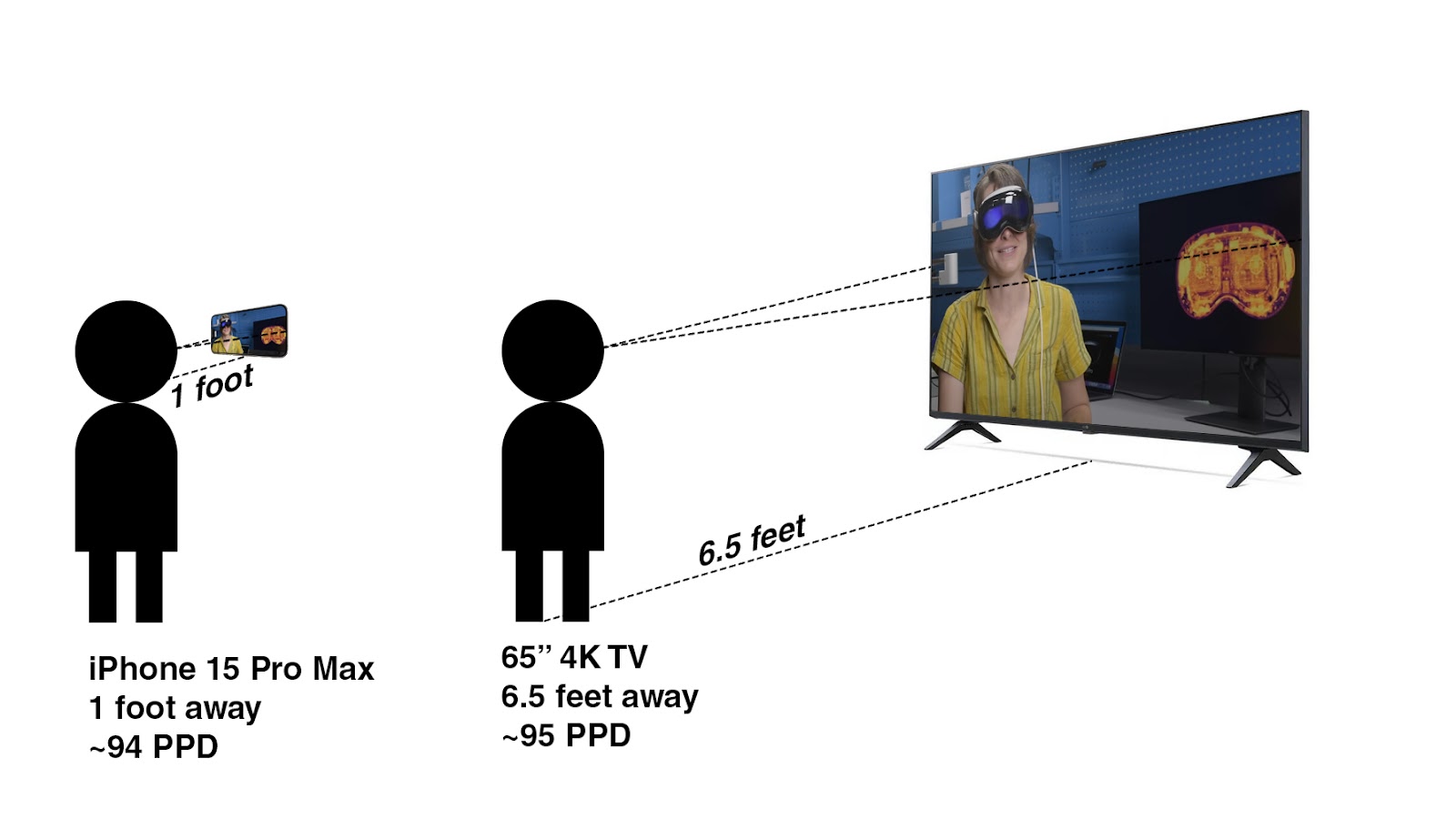

Pixels Per Degree: It’s All About the Angle

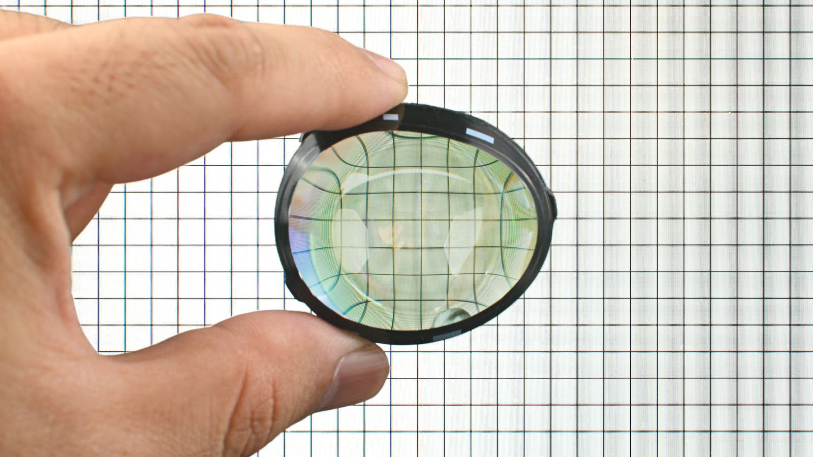

A high pixel density alone doesn’t guarantee a great visual resolution. Consider a 65″ 4K TV, which has a “paltry” 68 PPI. But your 4K movie still looks great on it. Why? Because you’re sitting pretty far away from the TV, effectively shrinking all the pixels down to a small area. The further away you sit, the higher the PPI scales. Think of how the Jumbotron at your local sports venue doesn’t look pixelated when you’re sitting across the stadium.
Because of this, VR engineers like to use a slightly fancier metric to measure display “goodness”: angular resolution, measured in pixels per degree, or PPD. This is the number of horizontal pixels per degree of viewing angle, and it lets us compare between displays with different resolutions, designed to be viewed at different distances.
But even that isn’t the whole story, for a variety of reasons:
- The PPD changes from the edge of the screen vs. the center.
- Lenses intentionally distort and tweak the PPDs in wonky ways.
- Stereoscopic views affect how many “pixels” are seen, muddying calculations.
With a rough measurement of 100° FOV (Field of View), we estimate the Vision Pro to have an average of 34 PPD. In comparison, a 65″ 4K TV viewed 6.5 feet away is 95 average PPD, and the iPhone 15 Pro Max held 1 foot away is 94 average PPD. Even though the pixel density and physical dimensions are drastically different between the iPhone and the 65” TV, they end up having similar PPD simply because of how they’re viewed.
Tl;dr: The Vision Pro may have an ultra-high resolution (PPI) display, but because it’s so close to the eye, it has low angular resolution.

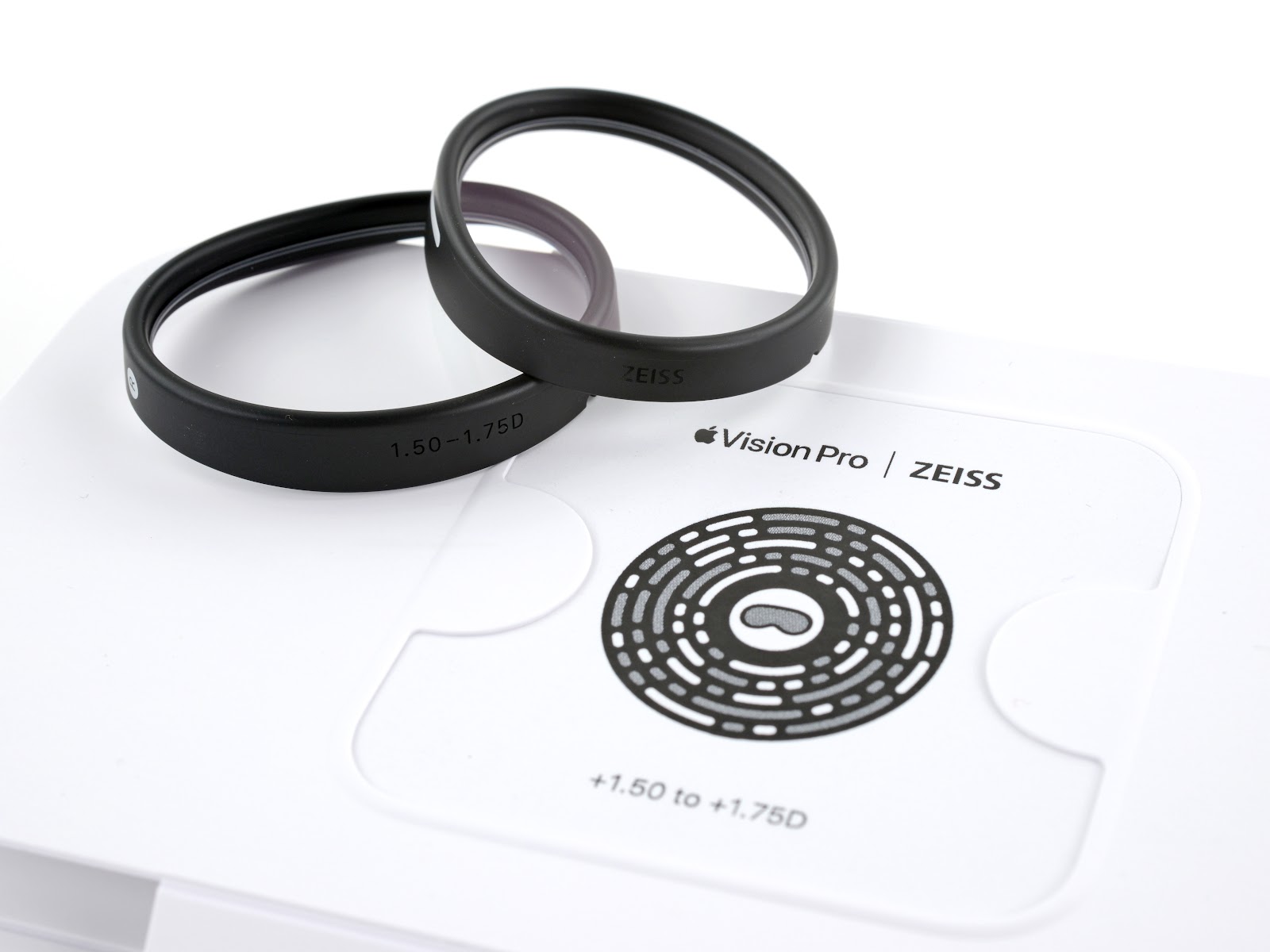

Wearing glasses under your VR headset is less than ideal—Apple’s answer is to add accessory lenses inside, for the Vision Pro, those lenses are made by noted German optics specialist ZEISS and snap into place magnetically.
Each lens comes with a pairing code, although this isn’t quite the same kind of parts pairing we usually deal with. These codes don’t lock a component to a single device. If you want to remove your prescription lens inserts from your own Vision Pro and drop them into a friend’s unit, you can. You’ll just have to pair them with the new headset by inputting the same code. The Vision Pro they’re being swapped into has to know the prescription of those lenses and calibrate accordingly, hence the little QR-type code you scan by looking at it during the setup process.
Still, it is parts pairing in that a secret handshake code is required to install lenses—giving ZEISS a solid monopoly, at least for now. It also means that any typos or shipping snafus might render your new lenses useless, at least temporarily.
You’d think that submitting a prescription would be enough to get the Vision Pro calibrated with your lenses—even if Apple is doing some fancy footwork—but without transparency, we can’t be sure.
The Vision Pro has another small problem for spectacles wearers. Contrary to some reports, Apple says that corrective lenses are available for most conditions, including astigmatism (which we weren’t sure about in part one), and they also offer bifocals, and progressives. But if you have a prism value included in your prescription, you’re out of luck. Prism correction is used to correct for diplopia, or double vision. The easiest way to see if your vision prescription is supported is to use ZEISS’s online tool.

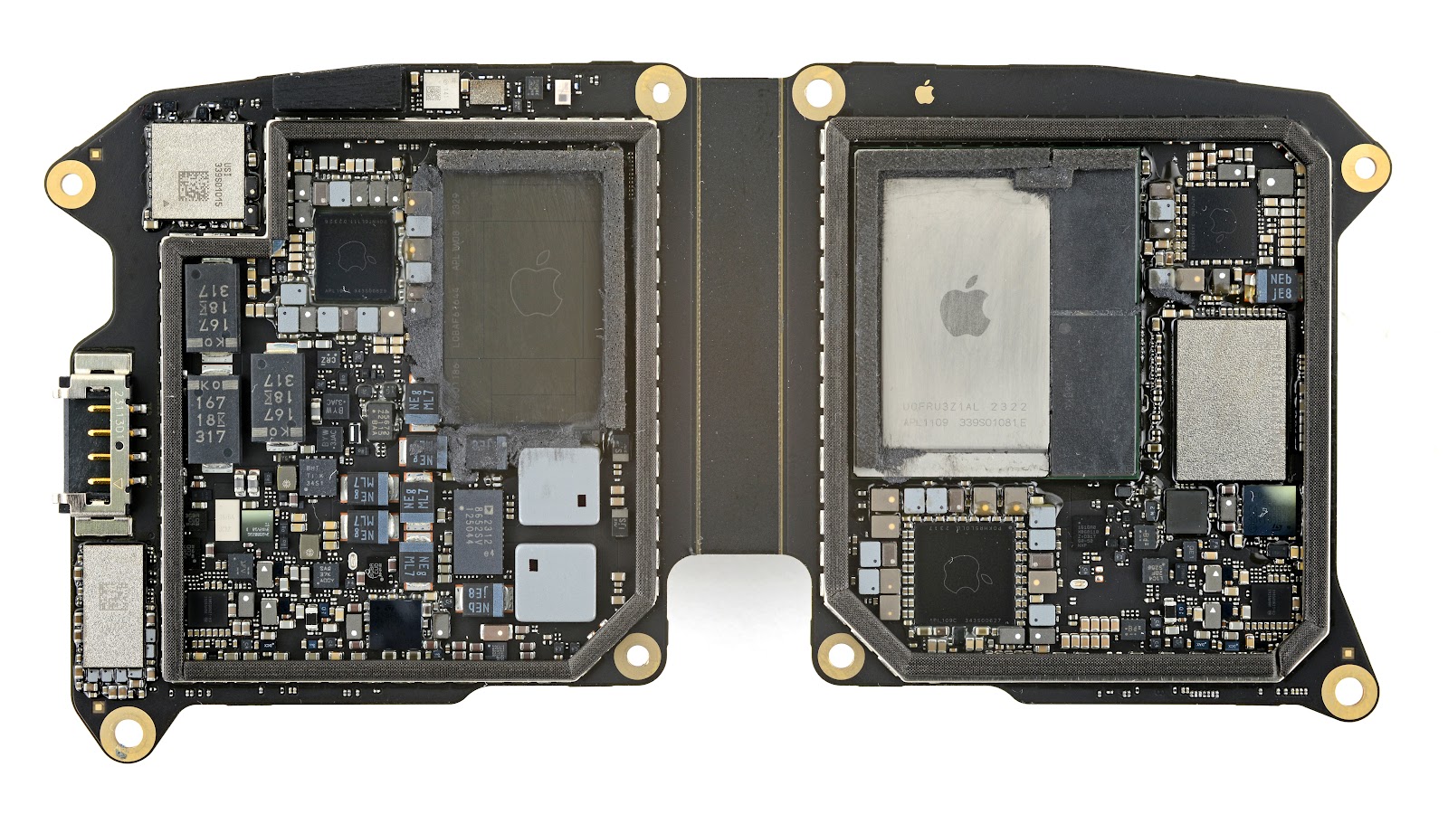

Chip ID
Apple highlighted the Vision Pro’s M2 chip and the new R1 chip in their announcement. But, what about the rest? And did you hear about the abnormally complex charging board in the battery pack?
We got you covered! Head over here to check out all the chips in the Vision Pro.

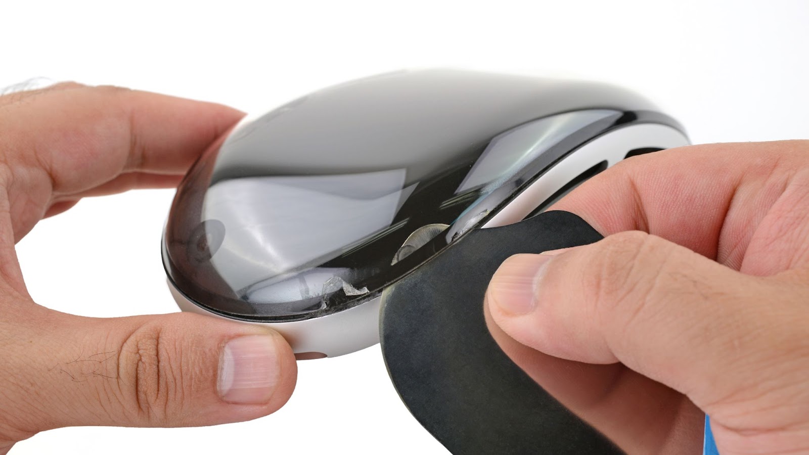

But on the other hand, getting to the front cameras and sensors—or anything behind the front glass—is a real headache. That glass cover needs a lot of careful finessing with a heat gun and multiple prying tools to remove in one piece. Sure, if you kill the EyeSight while trying to break in, it’s not the end of the world. The real danger is that cracking the glass might render the sensors behind it useless, simply by blocking their view.
Our repair scoring heavily weights parts like the screen and battery that are necessary for the function of the device. It’s hard to argue that the EyeSight display is a critical component. But the external sensors are essential, and if you break the glass and obscure them, then the device will stop functioning correctly.

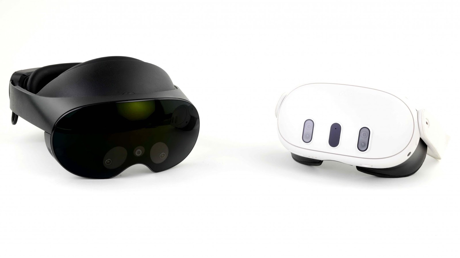

So how does the Apple Vision Pro compare on the repairability scale to head-mounted displays (HMDs) from competitors? Arguably the most important comparison is to Meta’s Quest 2 and Quest 3 headsets, which together dominate the VR and AR (collectively XR) markets with a roughly 70% market share.
The answer to that question, along with almost anything related to XR hardware, is that it’s complicated.
Let’s take the Quest 2 and Quest 3 as examples. Both are designed with a front-loaded headset secured by a replaceable harness, much like the Vision Pro. What differentiates Meta’s headsets from most others is that it’s also a standalone device, unlike the Valve Index, HTC Vive, and PS VR2. But that’s where the similarities between the Quest 2 & 3 and the Vision Pro end.
Where the Vision Pro has an external battery pack, both the Quest 2 and Quest 3 have their lithium polymer batteries buried inside the device, to the point that it’s one of the last things you’d remove in a highly complex repair. A battery replacement is the most likely and common repair, and in that category, the Vision Pro is a clear winner. That’s because the Vision Pro’s battery puck, while an integral part of the otherwise unpowered device, is an external component.
Where the Vision Pro fails is the fragility of the front glass, combined with the complexity of the User Interface (UI). Imagine you trip over the non-MagSafe battery cable and the headset tumbles onto your equally beautiful hardwood floor, shattering the glass EyeSight cover.
Even if every sensor is still functional, they will be blinded. When the external cameras’, LiDAR sensor’s, and IR emitters’ line of sight is interrupted by cracked glass, your hands won’t track correctly. Since there are no controllers (unlike most other HMDs), anyone with a broken front glass will have to lean on accessibility features like voice control.
The Quest 2 and Quest 3 fare much better on durability. For one, the exterior shell is made of plastic, which is far less fragile than glass. The cameras are recessed in their own notch on the case, thereby being a completely separate module from the rest of the HMD, allowing for easier repair and replacement.
Similar to the Vision Pro, the Quest Pro buries its cameras and sensors under the front plastic, but that front plastic is held in place by clips that simply pop off, allowing for easy and cheap repairs.
