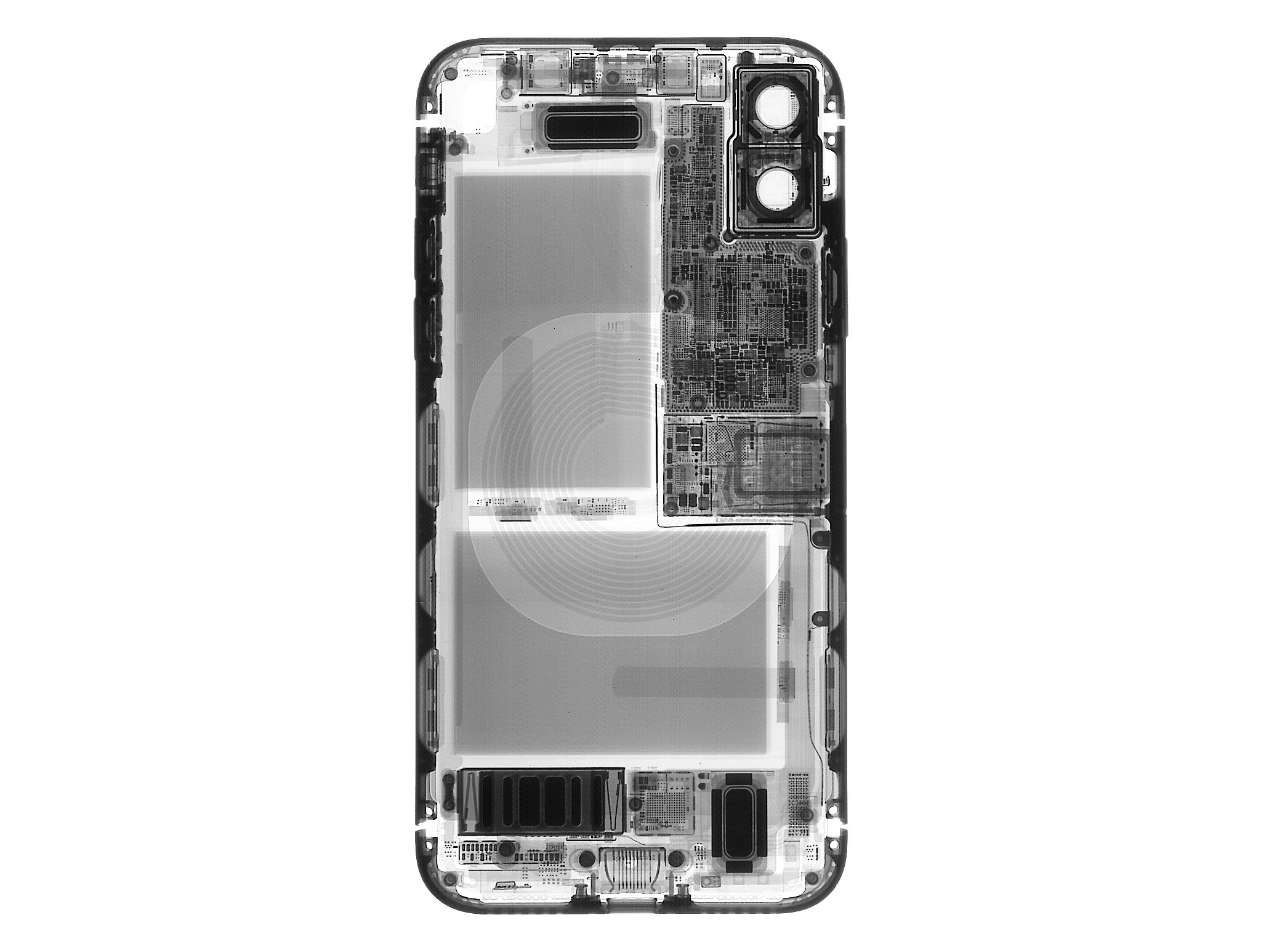

Okay, back to that battery. There’s no way to sugarcoat this: battery replacements in the Steam Deck are rough. Early reviews indicate that the Steam Deck can chew through a full charge in less than 90 minutes in some cases, and that means heavy users will see a lot of charge cycles and inevitably, battery replacement. Our best advice for this procedure is to drain the battery below 25% before you start, to prevent thermal runaway—and then use plenty of heat to soften the adhesive, and pry it out mainly from the bottom edge. Just watch out for the antenna hardware.
We’d like to recommend using a little isopropyl alcohol to make this easier, but, there are holes in the magnesium frame underneath, and we’re a little concerned the liquid might leak through there and muck up the display (which sits directly behind). Battery replacements definitely seem to be the Steam Deck’s Achilles’ heel.
The battery itself is a two-cell, L-shaped design, a fact which is even more apparent in our X-ray where you can see the outline of both cells clearly. It somewhat resembles the battery design we started seeing in iPhones a few years ago, starting with the iPhone X. This is no puny phone battery though; it’s rated for 40.04 Wh, or 5313 mAh at 7.7 V.
