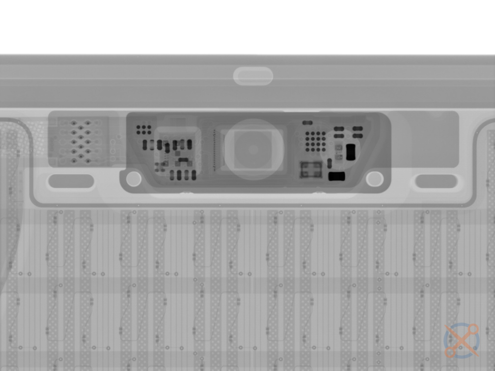

Speaking of Face ID, if you thought surely it would fit right into that display notch, we have news. Here’s a Face ID module from our recent iPhone 13 teardown, alongside the MacBook Pro’s display for comparison. These sensor modules have literally been reaching new heights, and seemingly won’t be squeezing inside that uber-thin display lid anytime soon. That said, there’s a curious amount of space carved out here for a simple webcam. Check out this X-ray of the notch internals:
In this image you can clearly see the camera sensor at the center, with its indicator LED just to the right. At left is (presumably) the ambient light sensor. And then, vast stretches of additional notch to either side. The notch itself remains a somewhat divisive design choice (as it has since its introduction in the iPhone X)—especially considering how slow Apple was to implement the necessary UI accommodations … and still is.
